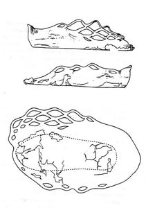

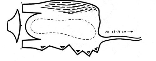

Funnily, after the first test I was browsing the web for other similar styles and no sew designs and I stumbled across a 4th century design from Northern Europe. Known as the Damendorf or Barbarian shoe it was fabricated using one piece of heavyweight leather and as such required no stitching. I was certainly surprised to see such a similar looking design from such a long time ago! Well, it is said that fashion designs get re-circulated!
