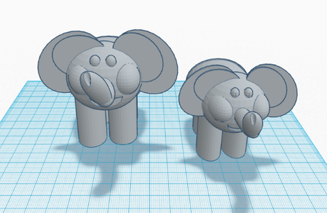

Almost all animals that i have created have the body structure made with a cylinder and two half spheres except the pig, the crows and pigeons (as far as I remember ...)
To give volume to the elephant's face put two spheres, one on each side coupled to a larger sphere. The elephant's trunk or the camel's neck were made with parts of Torus Thick.
