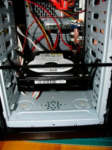

A guide to a noise free HDD using stuff you can find in every home. With some rubber and little patience you may turn a Raptor into a quiet baby.... :)
Every HDD makes some noise...Fact
But! This noise is in fact amplified as HDD touches the metal case of our PC.
So if between our case and the HDD is something else (see rubber strap from a tire inner tube) then the noise is deduced significantly!
Step 1: Materials Needed
The materials you need are:
Cross cuts from a tire's inner tube (or anything like a rubber strap)
and some screws.
Step 2: Getting the HDD Out and Making Some Space
First thing you need to do is ground yourself and remember to handle carefully all the electronic equipment.
Now open the PC case carefully and take the HDD out by unscrewing and unplugging.

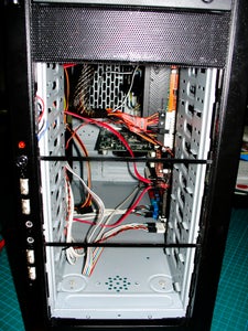

We need to use 2 5,25 slots (the big ones) so make some space for this.
Step 3: Screwing the Rubbers
Screw the rubber straps on the HDD and then while holding in air the HDD on the case...
If you cant screw them on th Pc case (possible) then thing about securing them with plastic straps (like i did)
Step 4: Final Thoughts
The mod is almost ready!
Dont forget to ground the HDD via a conductive cable leading to the case...
And dont shake your PC around UNLESS you secure the HDD or remove it from this fragile position.

    Wouldn't putting rubber on both sides of the computer case on the screw that mounts the HDD negate the vibrations traveling through the screw as long as its in tight but not too tight? Refer to picture.

    its a good idea but i think the rubber washer will be too dense to absorb some of the vibration. i did something similar to this but used surgical tubing and i strung it across and set the HD on top of it. i don't move my case when it is running and it is in a place that does not get kicked or bumped but to ensure the HD would stay put, i used some thin plastic ties and ran it in the screw hole of the drive and around the surgical tubing... it does not move at all, looks neat, does not sag much at all so you can stack the drives fairly closely together in the case, is cheap, and it very very quiet... it is very nice. liknus, Thanks for putting this up :-) WL

    You can buy exactly this type of isolating mount but in silicon rubber, my Vantec P180 case at home comes with them, and the result is almost no disk noise. Having big fans running at slow revs also helps!
