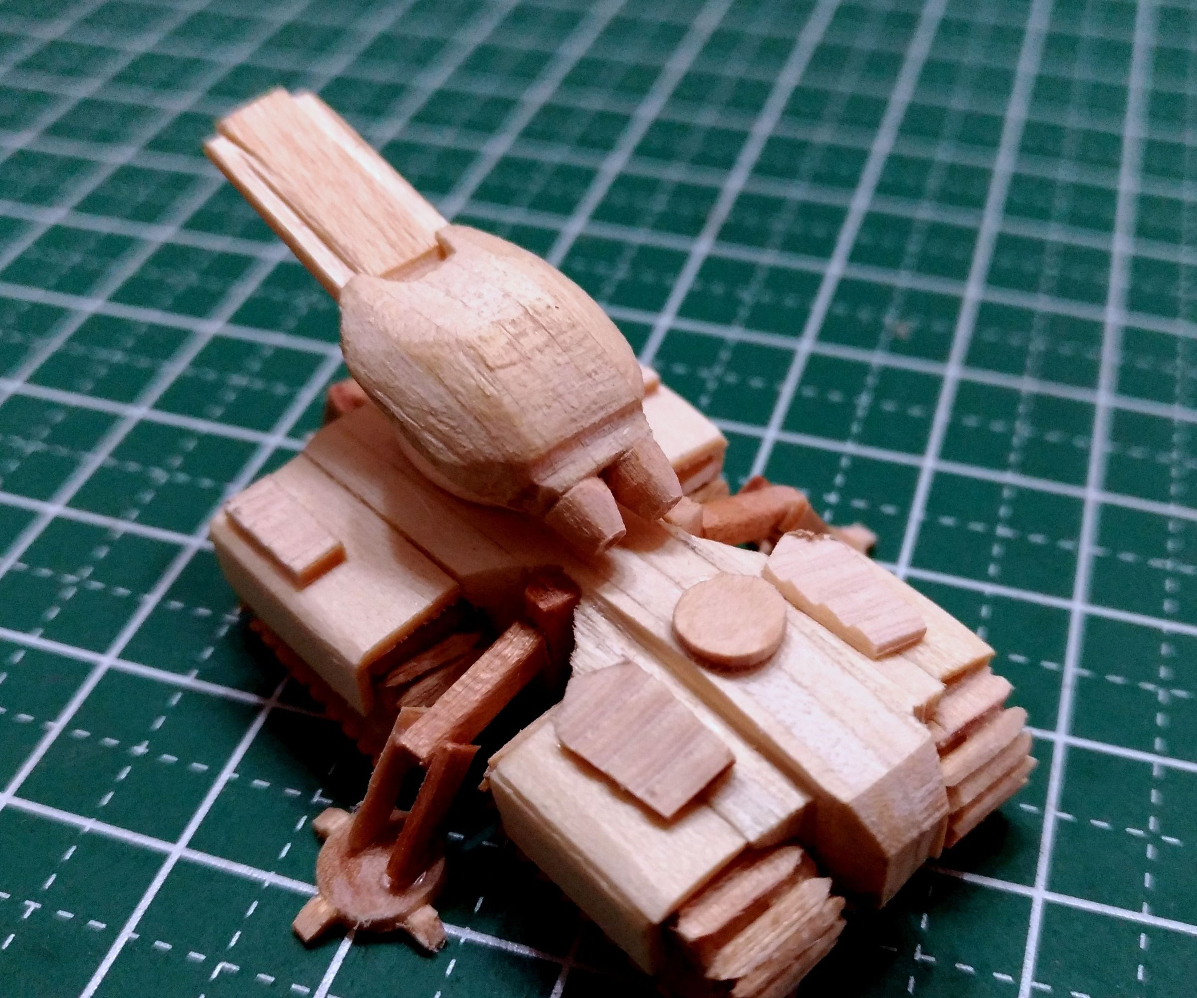

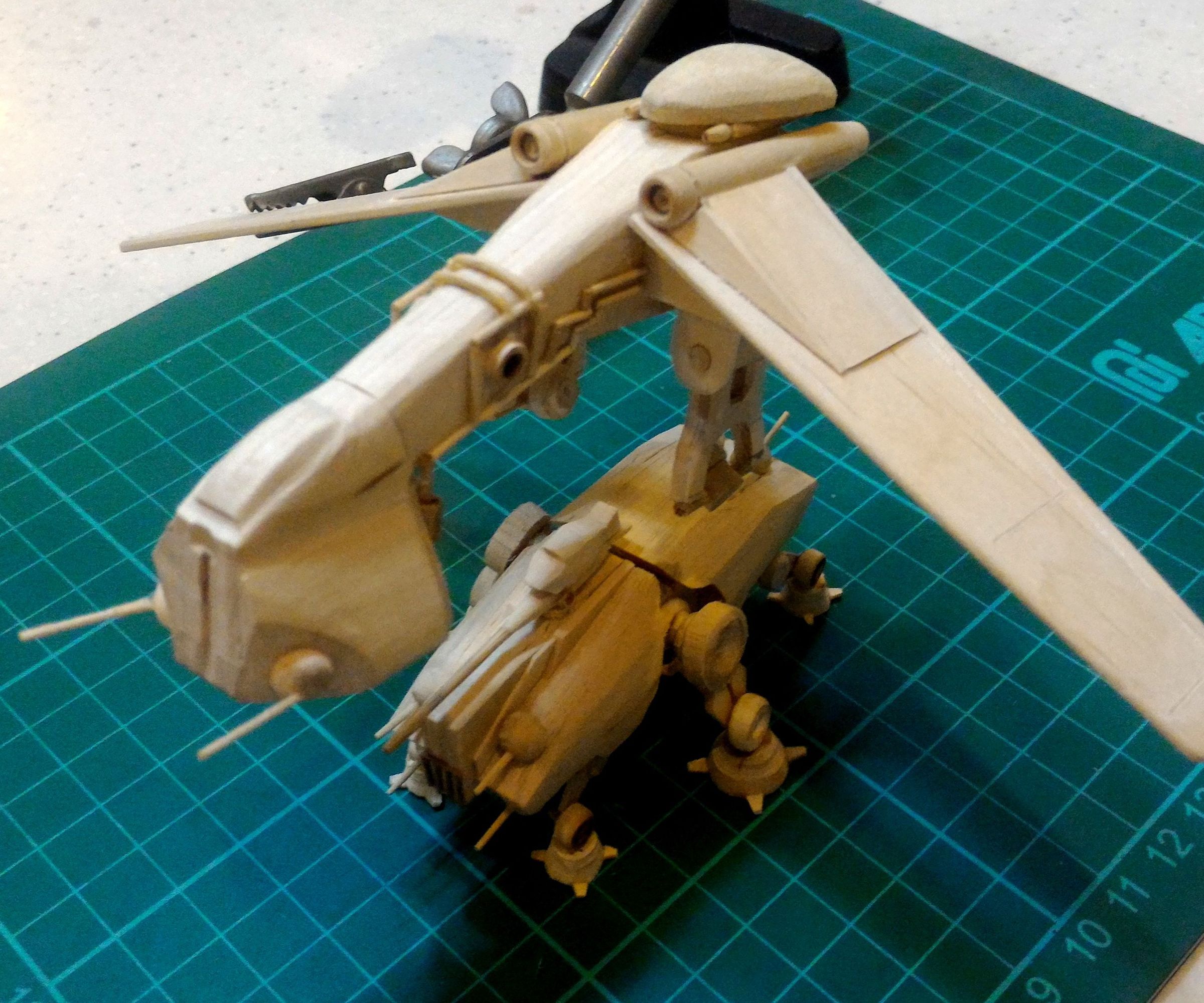

    7 years ago on Introduction
    hi! this its the first model i made using this technic hope you like it... sorry for my english im from mexico city, and i love this page. tnks.
    CAM00099.jpgCAM00100.jpgCAM00101.jpg2014-11-30_23-41-33_HDR.jpg2014-12-02_22-06-10_HDR.jpg2014-12-02_22-07-21_HDR.jpg2014-12-02_22-08-21_HDR.jpg2014-12-02_22-10-48_HDR.jpg
    0
    popsicle_mini-models
    Reply 7 years ago on Introduction
    A very impressive first project. Download more images and more schematics from the web and let your new found skill do the rest. Congratulations!
