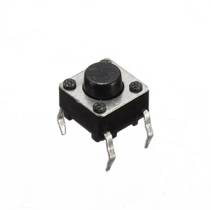

  2. Push buttons (5 total: UP, DOWN, LEFT, RIGHT, RESET)
  3. External pull-down resistors (for button stability)

  1. Connect the Buttons
Connect each directional button to the respective pins on the Nova board:
  1. UP Button: connect to pin 2
  2. LEFT Button: connect to pin 3
  3. DOWN Button: connect to pin 4
  4. RIGHT Button: connect to pin 5
  5. RESET Button: connect to pin 6
Use external pull-down resistors with each button to ensure reliable signal readings.
