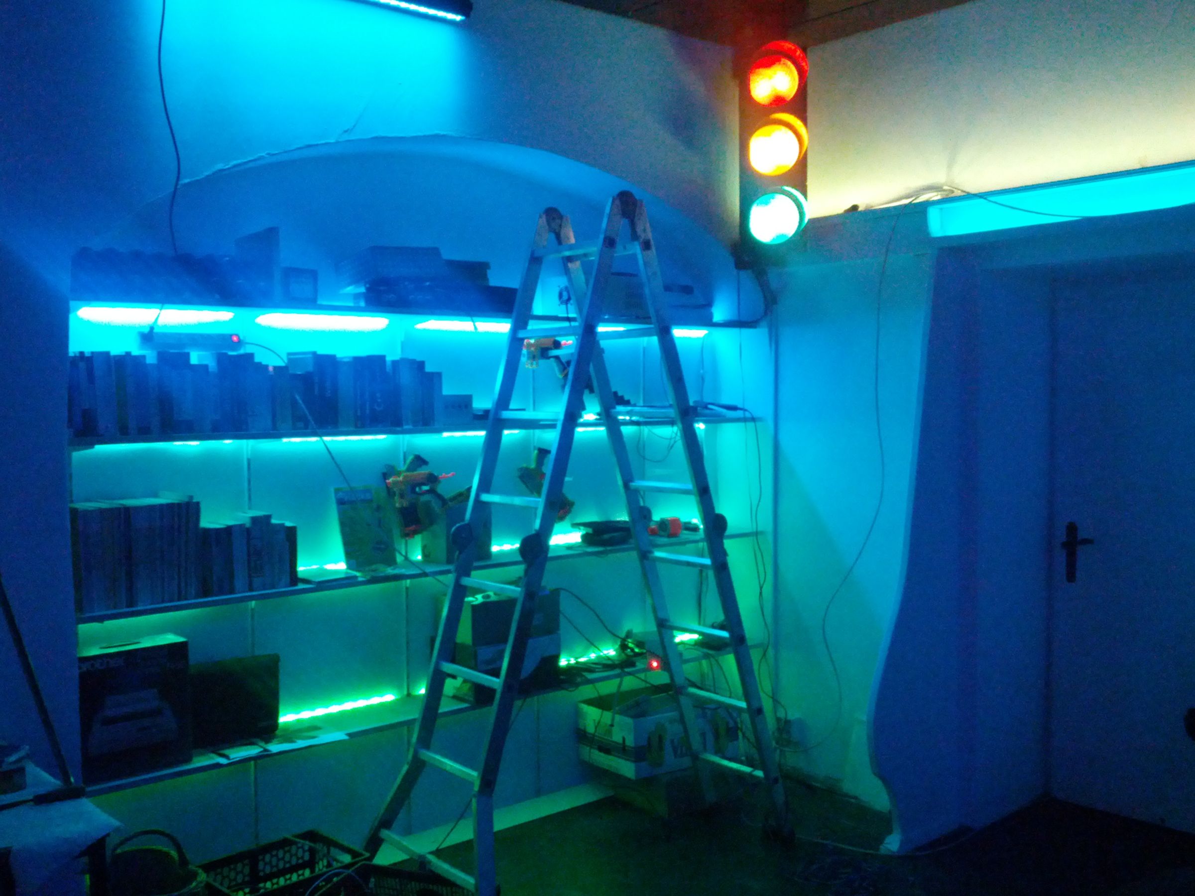

To create a playground for grown-up kids, we had to do something about the boring white walls surrounding it. So we decided to use the well-known internet meme Nyan cat as a decoration.
RGB LEDs

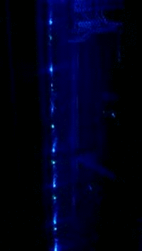

We used 16 LEDs for this project. Each LED was fitted with a 470 Ohm resistor to enable us to use 12 Volts as supply voltage. These LEDs can be ordered on ebay in a 50-piece package for a couple of euros.
A simple wire was used for the electrical connection. This is the same wire we used in our [[Hausbus|bus system]]. To solder the LEDs to the wire, we cut the wire isolation with a cutter at the GND and +12V wire and attached some soldering. After soldering the LEDs to the wires, everything was secured against short-circuiting with isolation tape.
All the soldering was done while power was supplied, to detect errors before it was filled up with concrete again.
Installation
To install the RGB LEDs we drilled holes into the wall. Using a chisel to get the slots was not the perfect way to do it because the wall is quite spongy. Pieces of the wall broke out and needed to be fixed with cement later.
In a second trial we used an angle grinder with a disc suitable for stone. This led to very clean cable slots. The disadvantage of this method was a lot of dust, which covered the complete room.
Finally the slots were covered with filler and painted in white color. This was followed by a blue color paintjob, identical to the background color of the nyan cat animation. To protect the LEDs from our (unskilled :)) painters they were protected by masking tape.
The outlines of the stars were formed with masking tape and the inside was painted in white color. The last step was to attach the nyan cat scarf with some nails.
