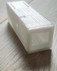

Step 5: Print the Case
The case design is available here: https://www.thingiverse.com/thing:4583703
It was initially designed for MH-Z19B but it can fit MH-Z19C just fine.
Step 6: Final Assembly
The front screen frame is quite fix, so it might need a bit of adjusting with a knife before installing the OLED screen. Do not try to force the screen into the frame as it might damage the screen.
