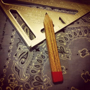

First step is to get all your ducks in a row. The oak I used is actually trim molding. 1/4 inch thick, 1/2 inch wide with one flat side and then one side the corners are chamfered. This stuff is very affordable, I paid .69 cents a foot at my local big box hardware store.

I used a razor blade to scrape off the excess glue. Then hit it with various grits of sandpaper starting with 60 and working your way up to 220. Then apply your Finish of choice. I wanted to keep things natural so I just used a butcher block conditioner.
I wanted to apply paint to mine to give the pencil a more finished appearance. I had some "Oneshot" brand of enamel paint, so I used that, but you can use any paint that you have on hand. I was just painting the end of the pencil so I just dunked it in so I wouldn't have to deal with brushes and clean up. Give the paint time to dry, the it'll be time to "sharpen" our new pencil and call this project done! Let's go!!

To sharpen the pencil we will be cutting the top end of the pencil into a pyramid. The first step is layout the cut lines. To do this measure down from the top 1 1/2 inches. Draw a square line on all sides of the pencil based on that 1 1/2 inch mark. At the top of the pencil, on each side, place a mark at the center. Place a straight edge on the center mark and the corner of the 1 1/2 inch base line, draw a line. Then do this on the other side of the same face. What you'll end up with is a triangle on each face of the pencil blank.
Now we cut. There's a thousand and one ways to do so. I cut mine by hand. If you have power tools that's even better. A miter saw would be best to get accurate angled cuts. If you're cutting by hand use an exacto micro saw, or a micro pull saw, DeWalt makes good one. The key is to use a saw with a thin kerf.
Alternatively you don't have to sharpen your pencil in a pyramid like mine. You could go the rustic route and just eyeball your angles, but with hardwood you'll need to saw. That's it, we're done!

I added a d-link to mine and put it on a retractable key clip for convince. The possibilities are endless as how you finish yours.
