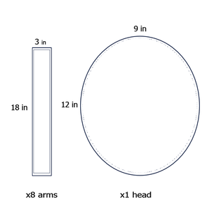

You will cut your octopus legs to size, you will find a (not to scale) pattern above. Measure 8 rectangles to be 18in by 3in and cut them out - no need to cut out the head yet.
After cutting out the material, start with one leg. Fold the leg in half with wrong sides together to get a long flat rectangle. Sew the two long edges together to create a long tube. Turn the tube right side out and stuff your lovely octopus leggie with stuffing. Sew up the remaining top and bottom sides of the leg. Now you have 1 octopus leg. Great! Repeat this process 7 more times until you have sewed and stuffed all 8 of your octopus legs.

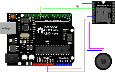

Step 4: (Part 2) Hookup the DF Player Mini to the Sensor!
Hookup your DF Player Mini using the arduino diagram above. The code below is for both the DFPlayer Mini and LED, so feel free to modify and use for your project! The code utilizes the DFPlayerMini_Fast arduino library to play and pause the sounds. Make sure that you have a Micro SD inserted into the module to test! Label your sounds as '001', '002, '003, etc. All you really need is one sound on the card to test. In the code below, the analog input from the pressure sensor affect both the LED's brightness and DF Player Mini's volume. The library comes with a function to change the volume (values 0 to 30) and functions to play, pause, and loop sounds. You can learn more about the library here: https://github.com/PowerBroker2/DFPlayerMini_Fast.
After fixing up the code and getting all your wires together, make sure to test the output to make sure you are achieving the desired interaction. Modify the code snippet below for your octopus' needs - especially the values in the map() function calls since your input from the pressure sensor will be different.
