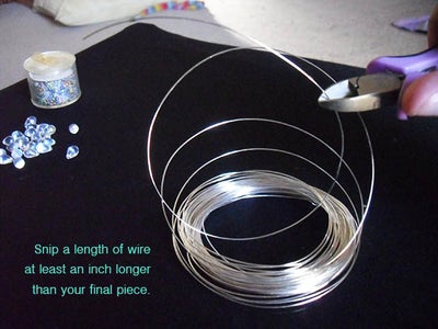

Cut a length of jewelry wire slightly longer than you intend the final piece to be. Give yourself at least an extra inch or inch and a half. I used 24 gauge medium temper wire; fine enough not to give the piece a bulky, wire-dominant look, and firm enough to allow some basic wire wrap work.

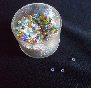

Start by threading on a single faux pearl or seed bead of your choosing. I feel the faux pearl makes a nice ocean-themed accent, and starting with a smaller bead traditions the eye to the large teardrops nicely.
