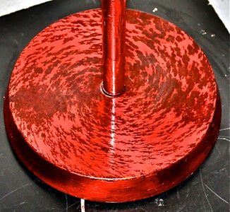

The rust on this project added a very cool effect and I think is the best part, more rust the better.

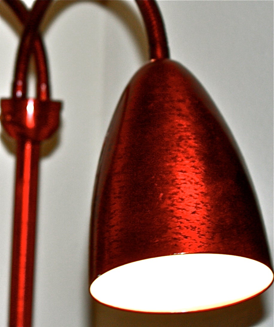

The goal with the Candy Anodized Paint is a transparent finish (Effect Coat) applied over the existing base color in this case, Brass, Rusty Lamp.
Second Coat can be applied once the First Tack Coat has had a few minutes to set-up. Tacky to the touch, when paint strings between your finger and surface you're ready to go!
You want to keep a uniform finish over the entire surface and each coat should be evenly sprayed / applied. (Try not to overlap.)
Applying a Third Coat and additional coats is optional.
Use the same technique as described above for each additional coat. If you get runs or sags, it looks cool too, adding another effect!

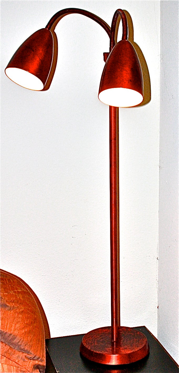

I sprayed 2 to 3 coats over the lamp to get the effect pictured.
The pictures are pretty close to actual color.
The Red Anodize over the brass pops and adds a really cool effect!
