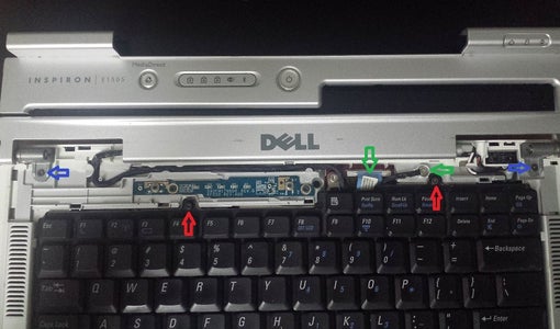

Step 3: More Screws and Stuff
Remove the keyboard
  • Note the screws with red arrows. Remove them.
  • NOTE: Some laptops have their keyboards held on by screws at the bottom of the laptop (usually denoted 'K').
  • Gently lift keyboard away from laptop body. There may be some glue/tape holding it down
  • Do not lift it too far, it is still attached via a cable (see other image)
  • Slide the entire keyboard upwards to expose the ribbon.
Detach Interface ribbon
  • Flip the latch of the connector up (to 90 degrees), starting on the side where the ribbon plugs into the connector. Apply gentle even pressure across the entire connector or you risk breaking it.
  • LIFT UP the ribbon from the connector. This particular ribbon have tabs on each side, so you cannot simply pull it out.
  • Set the keyboard aside
Step 4: Even More Screws and Stuff
Disconnect the Display
  • Refer to previous step for screw location
  • Remove the grounding screw for the display cable
  • Disconnect the display cable by grasping the blue tab and pulling firmly straight up
Disconnect other stuff
  • Disconnect the sleep switch (red and white wiring)
  • Disconnect the antenna wires from the WiFi card
