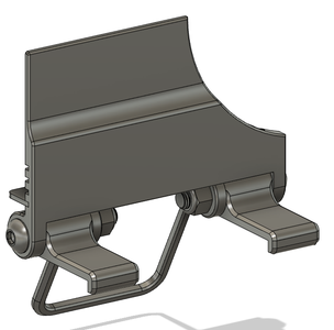

Step 1: 3D Print Parts
The .stl files are attached; you need one of each "Kickstand," "Platform," and "Main Body," and two "Hooks." The orientations should match the slicer image of the parts, and the print will need support. Ideally, it's good to print with a few perimeters (maybe 3 or 4) and pretty thick top and bottom surfaces (maybe 1.4mm each), but I was running mine on a makerspace printer and didn't want to take up too much time, so I ran with 2 perimeters and pretty sparse top and bottom infill.
This would ideally be printed out of PETG or something else that doesn't have as much of an issue with material creep, but PLA should work fine for at least quite awhile before you start seeing deformation due to creep.
If you don't have 5/16" screws, you can go into the provided "Phone Mount" Fusion360 file and change the hole features in each part to match your screws. They need to be at least 1 3/4" long, but as long as they're long enough and not excessively large or small, they should work fine. With whatever screws you're using, I'd recommend either locknuts, Loctite, or 2 nuts locked against each other to prevent the nuts from loosening.
Anyway, slice up some CAD files and get printing!
Step 2: Post-Process Your Prints
While hopefully your prints need minimal post-processing, mine certainly needed some cleanup. I started by removing the brim and cleaning up the edges that were on the build plate. This is best done with a deburring knife, but since I didn't have one available, I used an x-acto and some sand paper. This is something you'll be seeing whenever you're at your computer, so it's probably something worth taking a little time to clean it up. It's also important to deburr the insides of each of the screw holes, because the screws aren't meant to have much clearance and they might not quite fit if you don't deburr the holes.
Step 3: Assemble Phone Mount
Once you have all your stuff cleaned up, it's time to assemble the phone mount. Line up a hook and the kickstand with one of the holes, in the orientation shown above. Then, add the screw and locknut and screw them together, but leave it pretty loose. After this, add the hook to the other side, add its screw, and leave that one slightly loose as well.
After you have both on, tighten one of them incrementally until you can pivot the hook and kickstand with a little bit of force, but make sure it's tight enough that it won't move under the weight of the phone. Do this to the other side, and it's almost together.
Finally, you need to add the ledge. This will hopefully be a press-fit into one of the slots in the main body, though it might take some sanding if it's tight or masking tape if it's loose to get it just right. The particular slot you put it in should have your phone camera (I prefer the main camera, not the selfie-cam) just sticking out above the arched cutout. Start with the lowest level, which is preferable, but if your phone camera is covered by the main body at the lowest level, try the other levels until it isn't covered.

Step 7: Adjust the Mount and Set Up Charging Cable
Finally, it's time for it all to come together. You can adjust the phone mount hopefully with just a little bit of force, and it should stay in place with friction. You want the hooks to hook over the front of your monitor, and be flat with the top of it. If you adjust it so the hooks point down (like towards your keyboard), the mount might fall over. It's designed to be adjustable for almost all types of monitor, and it worked on all of them that I tried.
