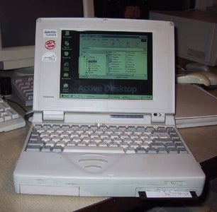

This might be extravagant, but if you take an old 486 or 386 laptop without a hard drive then you can easily turn it into a crazy clock. We have an old Compaq 486 laptop that uses only a few watts. The code for this program will work on most platforms that have some kind of basic compiler. I plan to make a bash version that will work on text terminals also. May make versions that will work on the apple and the android platforms. In any case it should make an interesting conversation piece and save one more computer from the landfill.

Step 1: What You Need.
An old low power laptop with bootable floppy drive.
Bootable dos floppy.
Qbasic or freebasic compiler.

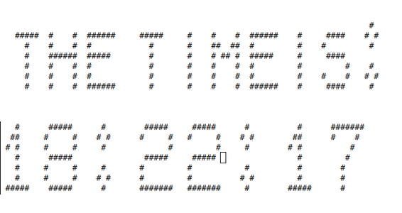

Step 3: Digital Clock
Compile the following code in the qb45 or freebasic compiler.  (c:\>fbc -lang qb digiclock.bas). We used the banner, toilet, and the figlet commands on linux to get the ascii art we needed. Preparing the ascii art was the hardest part of the program. Rest was simple.
[code]

'the logic
cls
locate 10,2: print"                                                                            #"
locate 11,2: print"  #####  #    #  ######     #####     #    #    #  ######    #     ####    # #"
locate 12,2: print"    #    #    #  #            #       #    ##  ##  #         #    #         #"
locate 13,2: print"    #    ######  #####        #       #    # ## #  #####     #     ####"
locate 14,2: print"    #    #    #  #            #       #    #    #  #         #         #    #"
locate 15,2: print"    #    #    #  #            #       #    #    #  #         #    #    #   # #"
locate 16,2: print"    #    #    #  ######       #       #    #    #  ######    #     ####     #"
locate 17,2: print ""
locate 20,20: print colon$(1);
locate 21,20: print colon$(2);
locate 22,20: print colon$(3);
locate 23,20: print colon$(4);
locate 24,20: print colon$(5);
locate 25,20: print colon$(6);
locate 26,20: print colon$(7);
locate 20,50: print colon$(1);
locate 21,50: print colon$(2);
locate 22,50: print colon$(3);
locate 23,50: print colon$(4);
locate 24,50: print colon$(5);
locate 25,50: print colon$(6);
locate 26,50: print colon$(7);
true% = -1
while true%
hrl$ = mid$(TIME$, 1,1): minl$ = MID$(TIME$, 4, 1): secl$ = mid$(TIME$, 7,1)
hrr$ = mid$(TIME$, 2,1): minr$ = MID$(TIME$, 5, 1): secr$ = mid$(TIME$, 8,1)
' hour left
    locate 20,1: print num$(val(hrl$), 1);
    locate 21,1: print num$(val(hrl$), 2);
    locate 22,1: print num$(val(hrl$), 3);
    locate 23,1: print num$(val(hrl$), 4);
    locate 24,1: print num$(val(hrl$), 5);
    locate 25,1: print num$(val(hrl$), 6);
    locate 26,1: print num$(val(hrl$), 7);
'hour right
    locate 20,10: print num$(val(hrr$), 1);
    locate 21,10: print num$(val(hrr$), 2);
    locate 22,10: print num$(val(hrr$), 3);
    locate 23,10: print num$(val(hrr$), 4);
    locate 24,10: print num$(val(hrr$), 5);
    locate 25,10: print num$(val(hrr$), 6);
    locate 26,10: print num$(val(hrr$), 7);
'minute left
    locate 20,30: print num$(val(minl$), 1);
    locate 21,30: print num$(val(minl$), 2);
    locate 22,30: print num$(val(minl$), 3);
    locate 23,30: print num$(val(minl$), 4);
    locate 24,30: print num$(val(minl$), 5);
    locate 25,30: print num$(val(minl$), 6);
    locate 26,30: print num$(val(minl$), 7);
'minute right
    locate 20,40: print num$(val(minr$), 1);
    locate 21,40: print num$(val(minr$), 2);
    locate 22,40: print num$(val(minr$), 3);
    locate 23,40: print num$(val(minr$), 4);
    locate 24,40: print num$(val(minr$), 5);
    locate 25,40: print num$(val(minr$), 6);
    locate 26,40: print num$(val(minr$), 7);
'second left
    locate 20,60: print num$(val(secl$), 1);
    locate 21,60: print num$(val(secl$), 2);
    locate 22,60: print num$(val(secl$), 3);
    locate 23,60: print num$(val(secl$), 4);
    locate 24,60: print num$(val(secl$), 5);
    locate 25,60: print num$(val(secl$), 6);
    locate 26,60: print num$(val(secl$), 7);
'Second right
    locate 20,70: print num$(val(secr$), 1);
    locate 21,70: print num$(val(secr$), 2);
    locate 22,70: print num$(val(secr$), 3);
    locate 23,70: print num$(val(secr$), 4);
    locate 24,70: print num$(val(secr$), 5);
    locate 25,70: print num$(val(secr$), 6);
    locate 26,70: print num$(val(secr$), 7);
wend

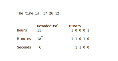

Step 7: Binary Clock.
Just had to do a very simple binary clock version.....  One way to get kids into mathematics.  (fbc -lang qb binclock.bas)
binclock.bas
[code]
' binary clock by computothought
'housekeeping
cls
true% = -1
locate 4,10 : print "The time is: "; time$;".";
locate 7,20: print "Hexadecimal";
locate 7,36: print "Binary";
Main loop
while true%
hr = val(left$(time$,2))
min = val(mid$(time$,4,2))
sec = val(mid$(time$,7,2))
'hours
locate 08,20: print "  ";
hr$ = right$("   " + hex$(hr),2)
locate 08,10: print "Hours";   : locate 08,20 : print hr$;
N=hr
gosub binit
bhr$ = C$
locate 08,30: print "                     ";
locate 08,30: print right$("                    " + bhr$,16);
'mins
locate 10,20: print "  ";
min$ = right$("   " + hex$(min),2)
locate 10,10: print "Minutes"; : locate 10,20 : print min$;
N=min
gosub binit
locate 10,30: print "                                 ";
bmin$ = C$
locate 10,30: print right$("                " + bmin$,16);
'secs
locate 12,20: print "  ";
sec$ = right$("   " + hex$(sec),2)
locate 12,10: print "Seconds"; : locate 12,20 : print sec$;
N=sec
gosub binit
locate 12,30: print "                                 ";
bsec$ = C$
locate 12,30: print right$("                  " + bsec$,16);
wend
' fake end
locate 14,1 : print;
end
'subroutines
binit:
C$=""
WHILE N <> 0
A = N MOD 2
B$ = STR$(A)
N = FIX(N / 2)
C$ = B$ + C$
WEND
return
[/code]

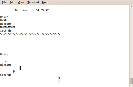

Step 8: Semi-analog Clock.
Did not have time to do a true analog clock, so I made a semi-analog clock, (fbc -lang qb analogclock.bas)
analogclock.bas
[code]
' semi-analog clock by computothought
'housekeeping
cls
true% = -1
locate 4,1: print "Hours";
locate 6,1: print "Minutes";
locate 8,1: print "Seconds";
locate 15,1: print "Hours";
locate 18,1: print "Minutes";
locate 21,1: print "Seconds";
'Main loop
while true%
locate 2,10 : print "The time is: "; time$;".";
hr$ = right$("00" + str$(hr),2)
min$ = right$("00" + str$(min),2)
sec$ = right$("00" + str$(sec),2)
lhr$ = left$(hr$,1)
rhr$ = right$(hr$,1)
lmin$ = left$(min$,1)
rmin$ = right$(min$,1)
lsec$ = left$(sec$,1)
rsec$ = right$(sec$,1)
'hours
locate 5,1: print left$(string$(hr,"H") + string$(60, " "),60);
'mins
locate 7,1: print left$(string$(min,"M") + string$(60, " "),60);
'secs
locate 9,1: print left$(string$(sec,"S") + string$(60, " "),60);
'hours
if hr = 0 then locate 16,1: print string$(60, " ");
locate 16,1: print string$(hr - 1, " ");lhr$; string$(60 - hr, " ");
if hr = 0 then locate 17,1: print string$(60, " ");
locate 17,1: print string$(hr - 1, " ");rhr$; string$(60 - hr, " ");
'mins
if min = 0 then locate 19,1: print string$(60, " ");
locate 19,1: print string$(min - 1, " ");lmin$; string$(60 - hr, " ");
if min = 0 then locate 20,1: print string$(60, " ");
locate 20,1: print string$(min - 1, " ");rmin$; string$(60 - hr, " ");
'secs
if sec = 0 then locate 22,1: print string$(60, " ");
locate 22,1: print string$(sec - 1, " ");lsec$; string$(60 - hr, " ");
if sec = 0 then locate 23,1: print string$(60, " ");
locate 23,1: print string$(sec - 1, " ");rsec$; string$(60 - hr, " ");
wend
' fake end
end
[/code]

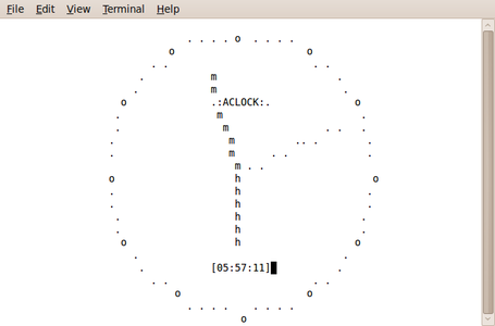

Step 9: Analog Clock in Progress.
Our goal is to work on an old laptop. That mean graphics are out of the question and you only have 4k of ram to hold the operating system and your program. If I use assembly language, I probably could of done something with graphics, but my time is limited.
www.delorie.com/djgpp/compile/
aclock_dos.c: (use at your own risk)
[code]
 * aclock - ascii clock for MS-DOS Text Mode
 * Copyright (c) 2002-2004 Antoni Sawicki <tenox@tenox.tc>
 * Version 1.9 (msdos-watcom); Dublin, July 2004
 * Compilation: Open Watcom 1.2
#include <stdio.h>
#include <stdlib.h>
#include <time.h>
#include <conio.h>
#include <graph.h>
#include <math.h>
#define PI           3.14159265358979323846
void draw_point(int x, int y, char p){
        char string[2];
        string[0]=p;
        string[1]=0;
        _settextposition(y, x);
        _outtext(string);
void draw_circle(int hand_max, int sXcen, int sYcen, int FontHW){
        double x,y;
        int r;
        char c;
        for(r=0;r<60;r++){
                x=cos(r*PI/180*6)*hand_max*FontHW+sXcen;
                y=sin(r*PI/180*6)*hand_max+sYcen;
                switch (r) {
                        case 0:
                        case 5:
                        case 10:
                        case 15:
                        case 20:
                        case 25:
                        case 30:
                        case 35:
                        case 40:
                        case 45:
                        case 50:
                        case 55:
                                c='o';
                                break;
                        default:
                                c='.';
                                break;
                draw_point(x,y,c);
void draw_hand(int minute, int hlenght, char c, int sXcen, int sYcen, int FontHW){
        double x,y;
        int n;
        float r=(minute-15)*(PI/180)*6;
        for(n=1; n<hlenght; n++){
                x=(cos(r)*n*FontHW)+sXcen;
                y=(sin(r)*n)+sYcen;
                draw_point(x,y,c);
void draw_text(char *p, int x, int y){
        _outtext(p);
int main(void) {
        char info[]="Written by Antoni Sawicki <tenox@tenox.tc>\nVersion 1.9; Dublin, Mar 2004\n";
        char digital_time[15];
        short FontHW = 2;
        short sXmax, sYmax, smax, hand_max, sXcen, sYcen;
        time_t t;
        struct tm *ltime;
        short unused;
        double test;
        for(;;){
                time(&t);
                ltime=localtime(&t);
                _gettextwindow( &unused, &unused, &sYmax, &sXmax );
                if(sXmax++/2<=sYmax++)
                        smax=sXmax/2;
                else
                        smax=sYmax;
                hand_max = (smax/2)-1;
                sXcen = sXmax/2;
                sYcen = sYmax/2;
                _clearscreen(_GCLEARSCREEN);
                draw_hand(ltime->tm_hour*5+ltime->tm_min/10, 2*hand_max/3, 'h', sXcen, sYcen, FontHW);
                draw_hand(ltime->tm_min, hand_max-2, 'm', sXcen, sYcen, FontHW);
                draw_hand(ltime->tm_sec, hand_max-1, '.', sXcen, sYcen, FontHW);
                draw_circle(hand_max, sXcen, sYcen, FontHW);
                draw_text(".:ACLOCK:.", sXcen-5, sYcen/3);
                sprintf(digital_time, "[%02d:%02d:%02d]", ltime->tm_hour, ltime->tm_min, ltime->tm_sec);
                draw_text(digital_time, sXcen-5, 4*sYmax/5);
                sleep(1);
    return 0;
[/code]
