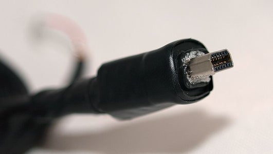

  • A prepared 12 pin remote cable. Follow the Olympus Evolt E510 Remote Cable Release instructions through step 8. Then return to this Instructable to complete the release. Check ebay for cables. I have found that most Olympus cameras use the same 12 pin connector as the Evolt series.

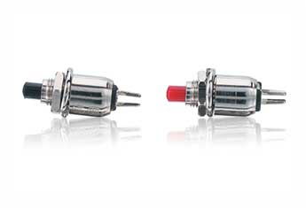

  • Two SPST Momentary push button switches Radio Shack PN 275-1571

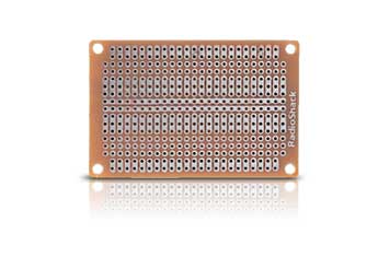

  • Radio Shack Multi Purpose PC board PN 276-150

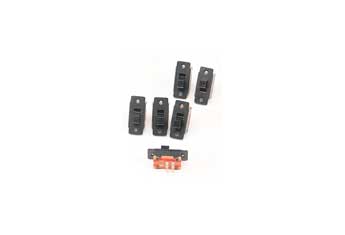

  • One DPDT slide switch Radio Shack PN 275-403

Step 2: Pepare the DPDT Switch
The DPDT switch has six connections on the bottom. Prepare it by connecting two hookup wires to the center connectors and two wires to either the left most connectors. The wires should be at least 7 cm long for now.
Check your switch with a multi meter if you have one handy.
The two center terminals (green) will be GROUND. Black is Pin 11, red is pin 3.

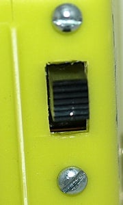

Step 3: Prepare the Enclosure Part I
Cut a hole 11mm long and 7mm tall on the hinge side of the enclosure using a utility knife or Xacto. Locate the hole about 15-16mm from the corner of the box and no more than 5mm from the hinge. Be sure that your switch will have a flat surface to mount to; the curve in the corner of the box will interfere with mounting if the hole is cut too close to the corner.
When cutting the hole, first draw out the shape and size needed with a marker. Then begin cutting by very carefully scoring the exact length of each line. Repeat this process, cutting slightly deeper each time. With patience it is possible to cut a very precise opening.
Insert the switch into the opening and mark the holes for the mounting screws. Drill the holes. Use the utility knife to enlarge the holes as necessary.
Measure the diameter of the cable. Drill a hole of slightly larger diameter in the edge of the enclosure to accommodate the cable. Locate this hole in any edge that will make holding the remote comfortable.

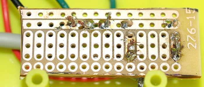

Step 4: Prepare the PC Board
Thread the camera cable through the opening created in step 3 before you being soldering.
If necessary, cut the wires for the DPDT switch so that they are a convenient length for the enclosure. Leave some slack to allow easy installation of the switch later.
Solder the components to the PC board using the schematic provided.
  • SW1 - DPDT slide switch
  • SW2, SW3 - SPST
Test your circuit using a multi meter. Once you are satisfied with the results, plug the cable into your camera and test it.
  • DPDT switch should result in a full button push - the camera should focus and release the shutter immediately.
  • SW2 should wake the camera from lite-sleep (monitor off) but do nothing else on its own
  • SW3 should auto focus and meter
  • SW3 and SW2 pressed together should result in focus and shutter release. Press SW3 to focus and then SW2 to release shutter when ready.
Cut the used portion of the PC board free using the Dremel tool.

Measure the distance between the center of each push button switch. The distance should be around 10mm if the Radio Shack parts were used.
Find a comfortable position on your enclosure and make two marks separated by the distance measured above. These will be the openings for the switches. Make sure the PC board has sufficient clearance INSIDE the enclosure. In other words, make sure it will fit inside the box.
Measure the diameter of the switches and drill two holes of that diameter. Check the clearances by gently inserting the switches. Use a knife or dremel tool to enlarge the openings as needed.
Step 6: Mount Everything
Mount the DPDT switch using the 6-32 screws and nuts. Mount the push button switches using the supplied lock washers and nuts.
