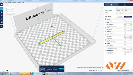

Once downloaded, you can open Cura and drag the downloaded .stl file into it. Position the bracelet on the printerbed, and make sure to select, "TPU 95A" as your material in the, "Nozzle and Material" dropdown menu located in the upper part of the right hand menu. Once you selected your print settings, you can insert an SD card into the computer's card reader and click the button in the lower right hand corner of Cura to save to the card.

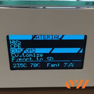

Have a technician change the filament of one of the Ultimaker to the TPU filament. They will need to use custom settings for the printerbed temperature, nozzle temp, and fan power. On printer 8 if you select, Material>Settings, there will be a custom setting called, "CUSTOM2." On any other printer you'll have to go to Material>Settings>Customize and manually enter these settings: Nozzle temp 235C, Printer Bed Temp 70C, Fan speed 35%.
Then navigate back to the main menu, select print, and select your model.
