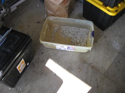

Step 2: Cleaning Gravel
This is the true grit, the right of passage for any AP system keeper. You must now clean your gravel. It is very rough going, i used a big colander and several batches of gravel under a hose, and more in the bathtub, and it still wasn't clean when i added it to the grow bed.
You can avoid all this by using LECA, expanded clay aggregate, a.k.a. Hydroton, instead.
Hydroton is also much lighter than pea gravel, if you can afford it, definately go for the Hydroton.
Otherwise, GET TO SCRUBBING!!!

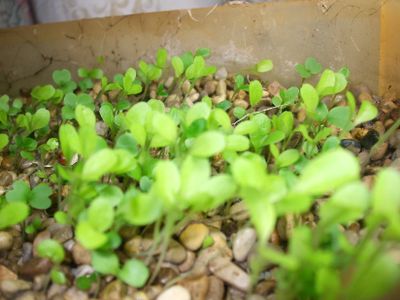

Step 5: Fish!
With this small setup I didn't want to go overboard with my fish. I stuck to 3 goldies and 1 crayfish. It's enough effluence to keep the small grow bed in nutrients, and enough grow bed to completely clean the water. I have my timer set so the pump is on for 15 minutes, then off for 15 minutes all day long. It's a perfect balance for what I have setup. That doesn't mean that there are hard and fast rules as to how to stock, how, or even IF to flood your growbed, or how to empty it. This is a simple example of this style of AP.
For this type (S&S Aqua Farm style) AP system, the stocking density and growbed to tank ratios are generally quote as 2:1 grow bed to tank and 1 pound of fish per 2 gallons of water (Note that this is an extreme in intensive aquaponics that is not recommended without extreme care and air pumps and stones). That doesn't sound to me like it would make for happy fish; but if you're in need a LOT of fish and crops, those are the limits.
I usually plant half of the grow bed at a time, so that when i harvest one side, the other side is still cleaning the water for me. I believe this is baby arugula i have growing in this pic.
