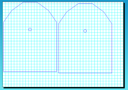

Before manufacturing the clock and gluing pieces together, I had to design what I was going to print. Above I have presented you with my CAD Files which were made on the software TechSoft 2D Design. I printed them with the laser cutter on either plywood or acrylic.
The blue outline is to cut, the red is to engrave, and the green is to deep engrave.

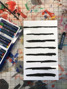

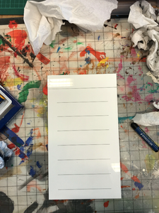

Once I printed the CAD Files for the Acrylic Whiteboard, I took the sheet of 3 mm white acrylic (I chose white so that you can easily see the writing on it), as seen from the first and second images, and since I engraved lines onto the piece of acrylic, I decided that to make them more visible, I would go over them with crayon. You can do it with any color, but I just chose black for the simplicity of it. You have to color on the engraved lines a lot and make sure that there are no spaces. Although it may look messy and permanent, you can remove the crayon piece very easily. After you finished filling in the engraved lines, take a tissue and wet it a tiny bit, so that it is damp, but not dripping. Then simply rub on the acrylic piece and it will remove. The final look is on the fourth image, and as you can see, it is very neat.
