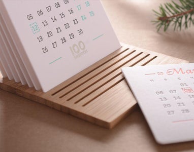

Now in the 21st century there are many variations of the calendar. Most often, people use the calendar on their phone. This is really handy as there are many different additional functions. It is possible to create a schedule for a specific day, turn on a reminder, for example, about the upcoming birthday of your friend. But despite all the advantages of electronic calendars, paper, plastic calendars are still relevant. You can, for example, put a small paper calendar in your wallet, so it will always be at hand.
Also, a calendar can be an interesting decorative element. There are many options for the original calendars that are easy to use and will look great in your workplace.
