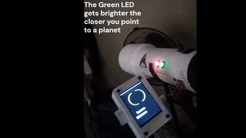

  2. Visual “lock-on” arcs (on the display) that merge into a full circle when perfectly aligned with a planet
  3. Plays discrete audio tracks from Outer Wilds for each planet, with volume that adjusts based on pointing accuracy

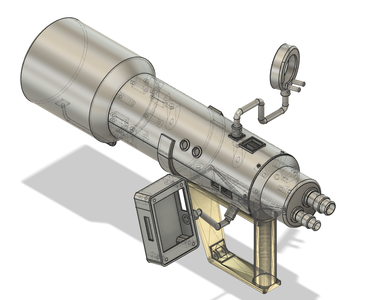

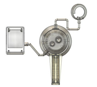

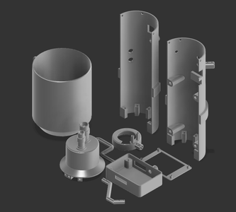

Step 1: 3D Printed Enclosures
the entire model consists of 3 colors: White, black and brown.
Signalscope_STL_v1.0.stl - either print in white and black simultaneously using a multi-color filament printer for a cleaner look, or print it in white and paint the black sections afterward.
Handle_STL_v1.0.stl - either print it in brown, or paint it brown afterward.
As for the material, use PLA for both prints.
signal scope
handle

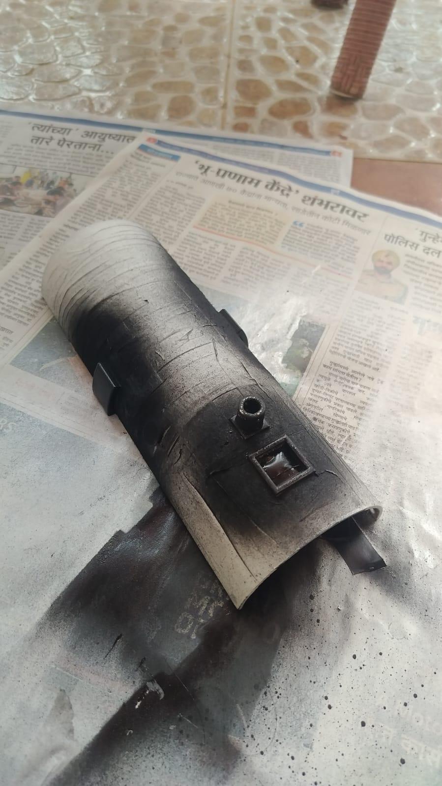

Step 2: Painting the Models (If You Used Single Filament Printer)
Once you have printed the parts, you can paint it first if you printed it all in white.
Refer to the image above to see which colors to use where.

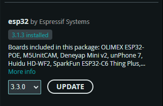

NOTE: If you are getting an "i2c master..." error (or any error which allows the code to get flashed to the esp, but doesnt run), try to
  1. go to boards manager in Arduino IDE
  2. search for esp32
  3. under the versions list, select and install v3.1.3
  4. DO NOT click on the update button when prompted to update to v3.3.0

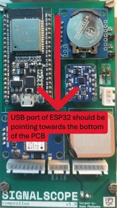

Step 7: PCB Assembly
ESP32 Placement
  1. The ESP32 development board must be mounted with its USB port pointing towards the bottom edge of the PCB.
  2. Ensure the board is fully seated and aligned with the header pins.
Antenna Placement
  1. The GPS antenna should be secured to the PCB using double-sided tape.
ICM20948 Orientation
  1. The positive X-axis marking on the IMU module must be oriented towards the top of the PCB.

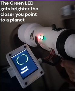

  3. Status LEDs:

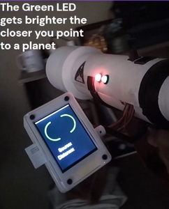

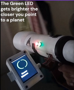

  4. Green LED - lights up with intensity depending on how closely you're pointing at a planet
  5. Red LED - lights up when esp32 is powered on and starts up

When you point the Signalscope at the sky, the IMU (Inertial Measurement Unit) senses its orientation. The microcontroller then uses the real-time clock to calculate planetary positions for that exact moment and location.
It calculates the device's altitude (angle deviated from horizon) and azimuth (angle deviated from horizon) angles and compares them to the azimuth and altitude of the planets from the solar system. The lesser the difference between them, the closer the semi-circles on the display get, until eventually forming an entire circle and turning blue; implying that you are pointing directly at a planet. The display then shows you which planet you're looking at, along with the distance between Earth and that planet.
Each planet is mapped to a unique soundtrack which will play when pointed at, and at varying volume levels depending on how close you are to pointing directly at said planet.
