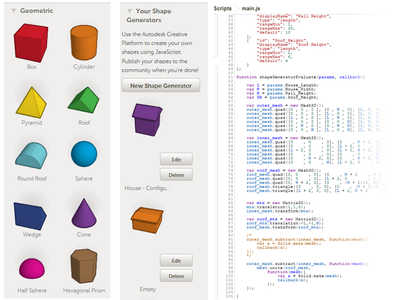

Tinkercad provides many generic geometric shapes that can be combined in any way to create more complex models.
If there is a shape you need that is not provided, or a series of shapes you combine frequently, Shape Generators allow you to use JavaScript to write code to automate the creation of new model shapes in Tinkercad.
