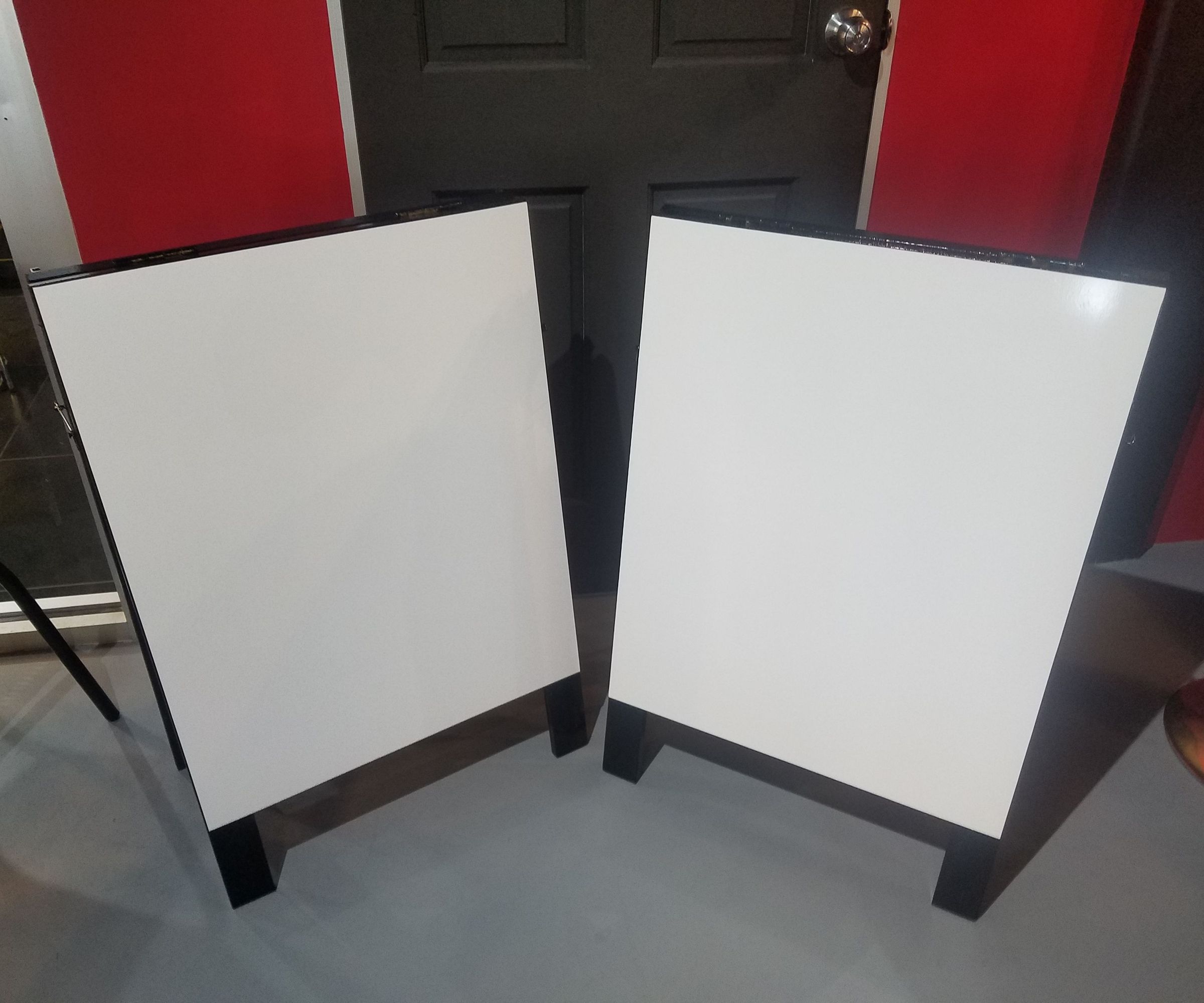

Step 3: BASE
For the base i made 2 shelves as legs, this can be cut to any desired shape but serve the same purpose.
Desks should not be more than 30" tall for standard height chairs
Materials cut:
2ft x 28" (2 pcs)
12" x 28" (2pcs)
center piece can be cut to any width as long as its 24" and 12" on either side to match the lenghts
See Images for referance.
