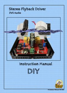

This is my design of a stereo flyback driver. (ZVS) You can drive 2 flyback transformers to create a 2 channel sound ( Stereo ). You can use square wave music as the sound sourse.
It's a fun little project that you can use to create awesome videos. Also, you will learn how to drive Flyback transformers; a technique that was used in old TV sets but if becoming less and less every day.
You can use any flyback transformer that you would like. Play around with old transformers that you harvest from old tv's or just buy new onces at Aliexpress or elsewhere.

The schematic can be divided into 3 sections. The bottom part shows the power connector ( P2) This is to connect the power. Pin 1 = ground ( negative) and pin 2 = 24V ( Positive). 24V is only needed to feed the flyback transformers. the test of the electronics only needs 12V that is why a Zener Diode D2 with serial resistor R15 are used. If all is well, LED LED2 will light up as soon as the unit has power.
The upper half of the schematic is the same is the middle parts. One half is used for the left channel and the other half is used for the right channel.
Both input connectors( P1 and P3) are connected with the jackinput J1 using jumper JP1. If you are planning to use the jack plug, you'll need to short all three pins of jp1.
The audio signal has to be a square wave audio file, that is very important as normal audio jumps all over the place, giving a result that is far from what we consider to be audio. I converted a midi file using Studio FL. In a nutshell, I attached a VST square wave generator to the midi channels I want to convert and saved is as an MP3 file.
The audio signal goes to the LM311 Comperator that is set at a threshold. Every time the threshold is breached, the Output of the LM311 enabled the NE555 Timer. When the NE555 timer is enabled, it runs at 22,5Khz ( adjustable by R4, R27) and it drives a Mosfet. The Mosfet drives your Flyback transformer that is connected to P20 / P4
The output of the NE555 is also connected to a led to see whenever the channel is receiving audio.
