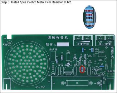

Step 3: 1pcs 22ohm Metal Film Resistor
Install 1pcs 22ohm Metal Film Resistor at R2.

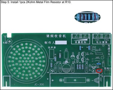

Step 5: 1pcs 2Kohm Metal Film Resistor
Install 1pcs 2Kohm Metal Film Resistor at R10.

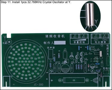

Step 11: 1pcs 32.768KHz Crystal Oscillator
Install 1pcs 32.768KHz Crystal Oscillator at Y.

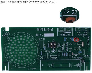

Step 13: 1pcs 27pF Ceramic Capacitor
Install 1pcs 27pF Ceramic Capacitor at C2.

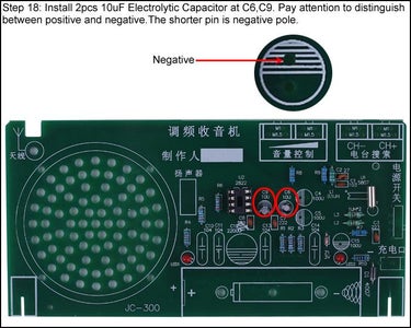

Step 18: 2pcs 10uF Electrolytic Capacitor
Install 2pcs 10uF Electrolytic Capacitor at C6,C9.
Pay attention to distinguish between positive and negative.The shorter pin is negative pole.

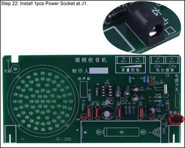

Step 22: 1pcs Power Socke
Install 1pcs Power Socket at J1.

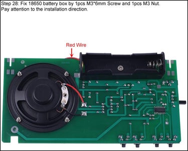

Step 28: Fix 18650 Battery Box
Fix 18650 battery box by 1pcs M3*6mm Screw and 1pcs M3 Nut.
Pay attention to the installation direction.

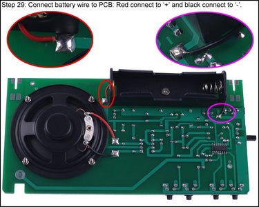

Step 29: Connect Battery Wire
Connect battery wire to PCB: Red connect to ‘+’ and black connect to ‘-’.
