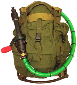

Introduction: POPCAP Powerful, Long Range Water Gun / Blaster / Soaker
This water gun uses regulated air to both pressurize the water and operate the trigger valve.
For additional information go to...
http://waterwar.net/forum/viewtopic.php?f=126&t=69...

Step 2: ASSEMBLE AS PICTURED
