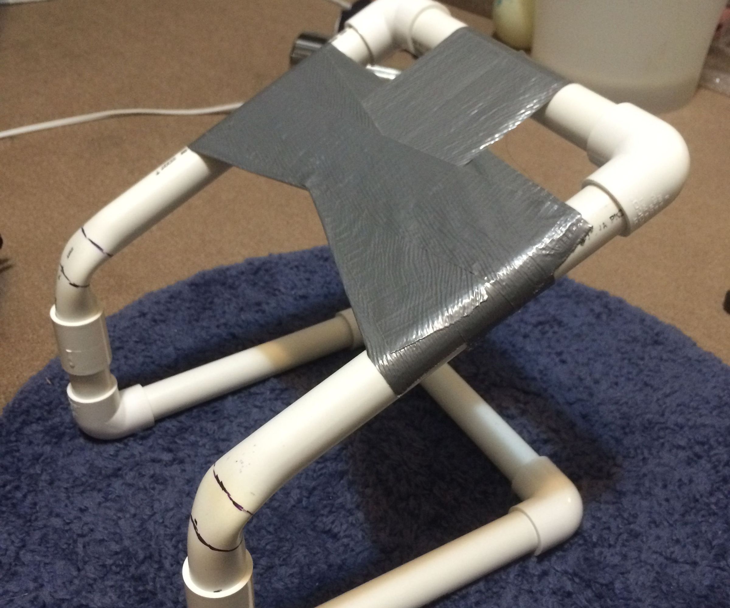

The main idea is to build a stand that can stand still (not fall) while the practice drum is hit as hard as an odaiko should be hit. With that in mind, the front is kept light while the back is given more support. Keep in mind that a real odaiko weight 3-digit pounds, while a steel practice drum might weight 10-20.
This stand has been both steady on hard wood floor and carpet floor, yep!

Step 3: Cutting the Pipes, Put Together
I don't know how to instruct you on this step; you have your measurement and I guess you'd just have to follow the plan.
Because I didn't have a plan when I was building the stand, putting it together was very clumsy; I was guessing the measurement, arguing with myself wither to add more support (more material, more trips to Home Depot). Perhaps this is necessary, as the plan might not work as expected. Prepare to adjust measurements during the process.
