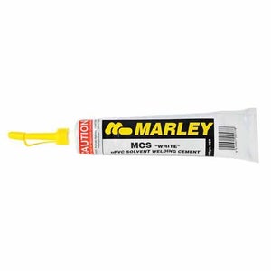

  • PVC Cement

The next step is to put a small amount of PVC cement onto the disc and then place the second disc onto the bolt. Lastly, put a washer and nut on and tighten this down.
A small amount of PVC cement will probably squeeze out, you should wipe this off with a rag. A splash of acetone (or finger nail polish remover) on the rag will help clean this up.
