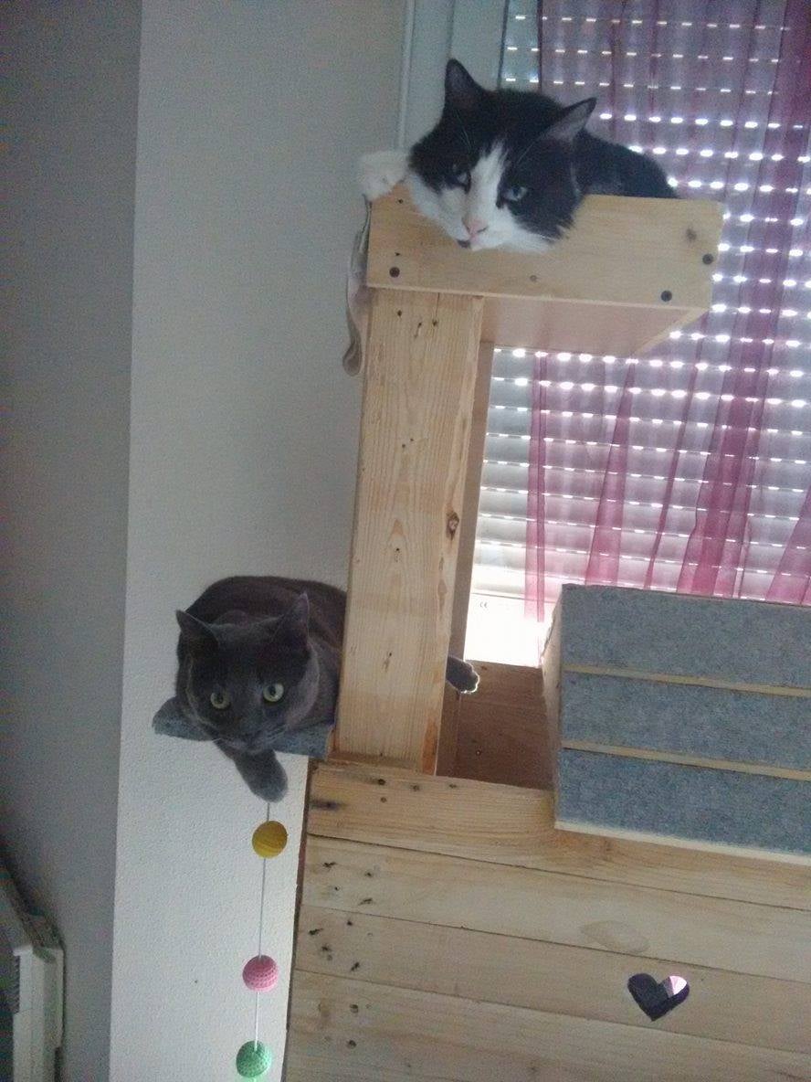

For cats can climb and walk everywhere, I fixed a terrace and 2 steps around the house with screw and some metal brackets.
Top floor is 35*40cm
Steps are 20cm width
==> special thanks to my parent's cat for testing the top floor and give me her approbation

Step 7: Spy-hole
To create a spy-hole heart shaped, I drilled two 22mm holes side by side and I finished the shape of the heart with a jigsaw.
For higher cat discretion, I painted the inside heart in black (previously protected with tape).
Cats love to observe from the spy-hole.

Step 10: Mr Weepu House
Mr Weepu loves to spend days and nights in his new house and he is very proud when he invites her balcony neighbor.
