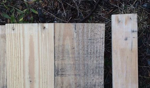

In disassembling the pallets, you probably found that planks are not standardized. You have different widths, different lengths and different thicknesses. We don't care so much about thickness, or even length, but width is important. You don't want to be playing Tetris on your wall, trying to make it fit. I'm not saying that it can't be done. I actually had multiple widths on my wall, but I made sure that each row was the same width. If you want to try the varied width approach, go for it. But be careful. It won't work without a lot of planning.
The first step is to organize your planks. Put the 2 1/2" in one pile, the 3 1/2" in another, the 4" in yet another. Essentially, just separate them. If it's 2 3/4", put it in the 2 1/2" pile. Round down. We're gonna rip these suckers anyways.

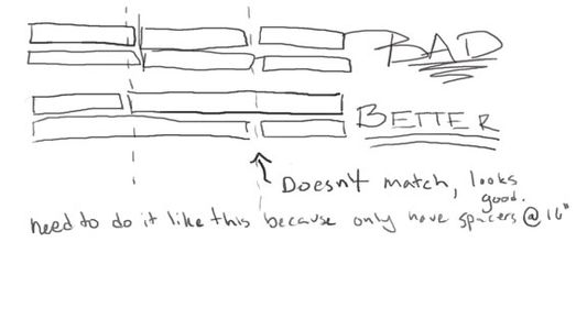

Lets start this ball rolling. With all the prep work out of the way, we can finally start on the wall. The first row needs to be level. Make sure you use the same width boards and to stagger the seams. The badly drawn photo shop sketch shows why. You COULD cut all the boards to 32" and then stagger them, but where's the fun in that? We do things impulsively and live life on the edge! Who cares if eventually we're gonna have seams match? Eh, whatever.
In all seriousness, if you're going for speed and efficiency, I would cut them all to 32". It looks just as good and makes the layout go much smoother. The way I did it is entirely random, yes, but it took a lot of thought to make the seams stagger most of the time.
In the pictures, you can see that sometimes they matched twice in a row, but I never had three in a row. That looks really bad.

If I was to do this again, I'd probably change some stuff. First up, the whole different length thing is great, but lots of work. Next time, I'll just use 32" or something like that. I like the color difference in the wood, so in choosing pallets, try to get different colors of wood. You'd be surprised at the amount of hardwood in pallets. Beautiful mahogany, rosewood, ironwood, great stuff. The thickness of the boards makes a huge difference. It adds texture and shadows, which just deepens the whole effect.
