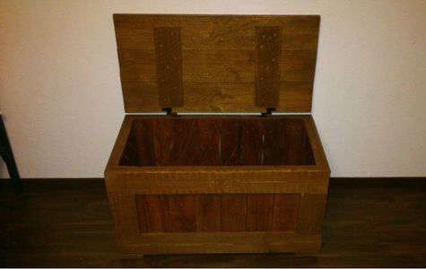

After reading a few instructables I decided to build something from pallets. Inspired by thesetwo projects, I decided to build a chest. This was my second project ever (first one was the coffee table that can be seen in the first image) so there is definitely room for improvement.
My goal was to use as much recycled (and more importantly free) materials. Unfortunately, varnish came surprisingly expensive to me but I got some on a discount when the local hardware shop changed owners. Apart from that I also had to buy vermin treatment, screws and the primer and coating for the fittings. The fittings themselves are from the streets.

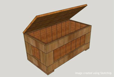

The actual design was done by hand but I don't have the sketches anymore. However, I also made a model in SketchUp, mainly to try out the program and because I couldn't continue work because our basement was flooded. Luckily, all the wood I was planning to use was on the table and the water didn't reach that high (you can see it on the wall). But at least there was much more room afterwards :D
The chest turned out pretty much as planned, I just had to use different boards in a few places because I ran out of wood.
The lid is the only part that used EUR-pallets. They are the boards that hold together the upper layer of the pallet (or cut to that length) which determined the width of the chest ( = depth of the EUR pallet)
Also the boards that hold the lid together are missing in the model. I attached them underneath the lid.

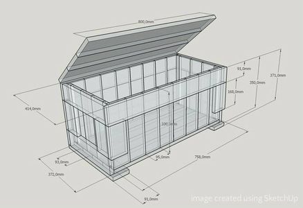

I added a picture of the model with dimensions. I went a little overboard because the tool is fun to use :D I removed the lower front part of the frame for better view.
The main dimensions are w x h x d = 80cm x 37cm x 41cm. The boards for the frame are all of the same kind, approximately 91mm x 21mm.
The lid was basically what I based the dimensions (width and depth) on. I was kind of lucky that I had the four boards for the bottom that came out to be the same depth together with the frame. Otherwise I would have had to cut them lengthwise to fit. I was again lucky that the boards I used for the front and back wall fit pretty good so I didn't have to adjust them. There is a little room at one of the corners but it is covered by the frame.
I also added the SketchUp Model file. I never really used software like this so I just took the first thing that popped up on google. Recommendations are welcome!

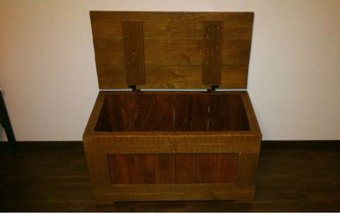

Originally I wanted to assemble the frame and then add the walls but the wood was too bent and twisted. I couldn't glue together the upper frame and didn't want to use screws because they would be visible from outside. So I put in the side walls first and attached the upper part of the frame to them.
I was really worried that it wouldn't be straight enough in the end but the lid fit perfectly!

Step 9: Done
I was really surprised how well it turned out considering the mediocre quality of the wood and my limited skills and tools. I just hope it doesn't come apart after a while due to tensions.
