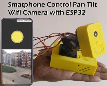

I am going to make a Pan & Tilt Camera with ESP32 Cam. This can be viewed & controlled via Phone or any web browser from Tablet , PC etc. This project can done in 30 minutes. Just connect the wire & upload the code to ESP32 quite easy. You just need to supply 5 volt from battery & can be installed anywhere as its very small.Total cost of the project is less than $15.

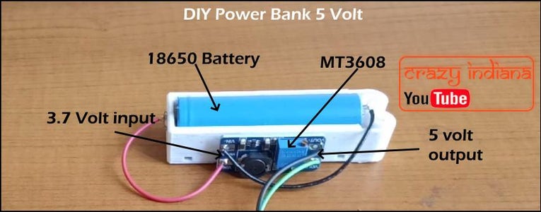

Step 1: Powering ESP32 Camera
To run this camera you need 5 volt. Either you can use a power bank to supply or make your own Power Bank easily. Connect 18650 Battery with MT3608 Power Booster Module and adjust the voltage to 5 volt. I used the same with a charger module TP4056 to charge the battery also.You can also use any 5 volt charger Module like 134N3P which default output is 5 volt.

Step 4: Connecting Servos & Camera
Now connect the servos & ESP32 Camera with the Power module as per circuit Diagram. I have used jumper wire to connect but you can solder it make more robust. Now open browser from smartphone, Tab or PC & type the IP address you got when you uploaded the code. Check video for details instructions. Now if you move the joystick on browser you could see the camera moving i.e. Pan & Tilt function.
