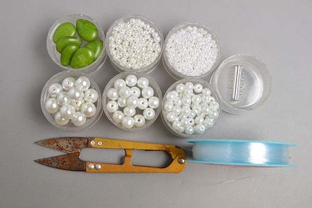

Step 1: Supplies You Need Prepare Before Making the Pearl Choker Necklace:
3MM White Pearl Acrylic Beads
4MM White Glass Pearl Beads
6MM Ivory Glass Pearl Beads
8MM White Glass Pearl Beads
10MM White Glass Pearl Beads
4-strand Slide Lock Clasps
Olive Drab Drop Jade Beads
Transparent Fishing Wire
Scissors

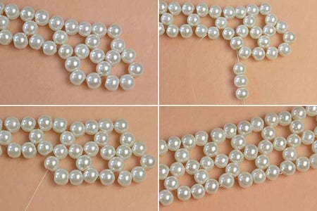

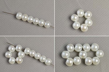

Step 2: Make 2 Pearl Beads Loops
1st, cut a long piece of fishing wire and slide 6 6mm ivory pearl bead to it;
2nd, cross the wire through all the 6 beads and make a knot, then cut off one end of the wire;
3rd, slide 5 6mm pearl beads to the wire and cross it through the first wire and tighten up, then cross the wire through next 3 beads as pictured.

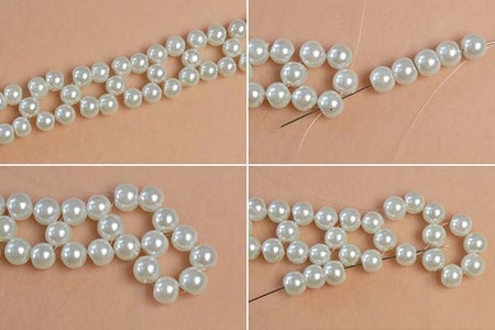

Step 3: Make More Bead Loops With 6mm Ivory Pearl Beads
1st, repeat step 1 to make more pearl bead loops until the length of it is enough to you;
2nd, slide 5 6mm pearl beads to the wire and cross it through a peal bead and tighten up the wire;
3rd, cross the wire through next pearl bead, slide 3 6mm pearl beads to it and then cross it through 2 pearl beads in 2 bead loops as pictured.

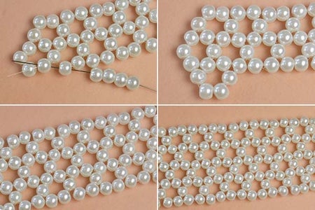

Step 4: Finish the Second Layer Bead Loops
1st, cross the wire through 2 beads in the first layer bead loops, then slide 3 6mm pearl beads and cross it through 4 beads as pictured;
2nd, repeat above steps to make other more bead loops till the end.

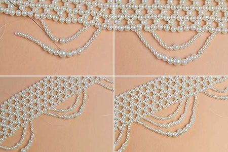

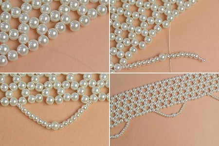

Step 6: Make Bead Drop Patterns
1st, cross the wire through bead loops to the 5th bead in the last layer, then slide 2 3mm pearl beads, 7 4mm pearl beads, a 6mm pearl bead, 7 4mm pearl beads and 2 3mm pearl beads to it;
2nd, cross the wire through the 14th bead in the last layer, along the next 7 beads and add 2 3mm pearl beads, 7 4mm pearl beads, a 6mm pearl bead, 7 4mm pearl beads and 2 3mm pearl beads to it;
3rd, repeat above steps to make another bead drop pattern as pictured.
Step 7: Make Other 2 Layers Bead Drop Patterns
1st, cross the wire through next 2 beads and slide a 3mm pearl bead, 8 4mm peals beads, 3 6mmm pearl beads, an 8mm pearl bead, 3 6mmm pearl beads, 8 4mm peals beads and a 3mm pearl bead to it;
2nd, cross the wire through the 3rd bead beside the left side of the first layer bead drop pattern;
3rd, cross the wire through next 3 beads and make 2 second layer bead drop patterns as pictured;
4th, cross the wire along the last layer to the 2nd bead beside the 2nd bead drop pattern, then slide a 3mm bead, 9 4mm beads, 3 6mm beads, 2 8mm beads, a 10mm bead, 2 8mm beads, 3 6mm beads, 9 4mm beads and a 3mm bead to it, then cross it through the 2nd bead beside the right side of the 2nd bead drop pattern.

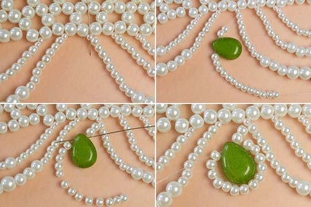

Step 8: Add Olive Drab Jade Drop Bead to the Peal Bead Necklace
1st, cross the wire through the 3mm bead in the 3rd bead drop pattern, slide 2 4mm pearl beads, an olive drab jade drop bead and 13 4mm pearl beads to it;
2nd, cross the wire back through the jade bead, add 2 4mm pearl beads to it and cross it through the 3mm pearl as pictured.

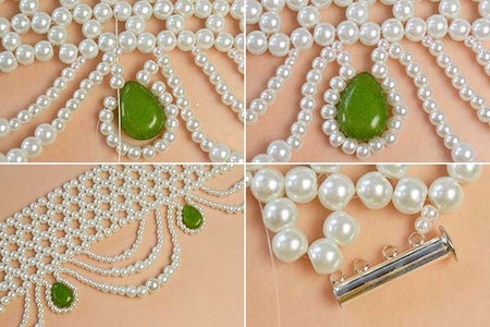

Step 9: Add More Beads and Clasp to the Necklace
1st, repeat step 7 to make a bead pattern with jade bead at left side as pictured;

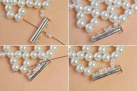

2nd, slide 2 4mm pearl beads to the wire and cross it through a hole of a side lock clasp.
Step 10: Add Some Pearl Beads to the 2 Sides of the Lock Clasp
1st, slide 2 4mm pearl beads to the wire and cross it through the e2nd hole of the clasp;
2nd, cross the wire through the 3rd hole and add 2 4mm beads to the wire, then cross it through the 4th hole of the clasp, add 2 4mm beads and cross it through the last hole of the clasp;
3rd, cross the wire back through the 6mm pearl beads loop and continue to add 4mm pearl beads on the corresponding side of the clasp as pictured.

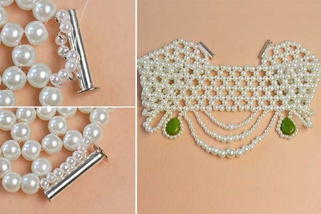

Step 11: Finish the Pearl Cjoker Necklace
Repeat step 9 to make the other end of the pearl ckoker necklace with pearl beads and the other part of the side lock clasp.

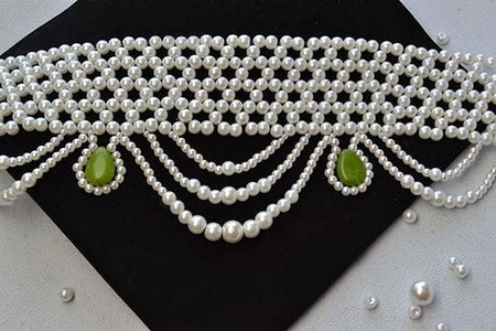

Step 12: Here Is the Final Look of This Pearl Choker Necklace.
How do you like this pearl bead necklace? I love this necklace the first sight I met it, and I will make it later, so do you wanna join me to make one as well? Follow my detailed steps, then you will make such a chic pearl choker necklace! Have fun~
