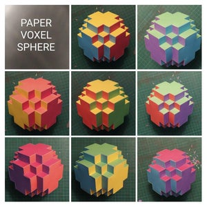

Hello again! I couldn't get this idea out of my head. I needed to see if it was possible to do a more complex shape than the 3D Paper Cross I made last week. The results give a much more striking paper model but it's not for the faint of heart. There's a lot more cutting, there are a lot more folds and a lot more tabs for gluing. As a result it took me a lot more time, about seven or eight hours. The 3D Paper Cross is much easier and quicker I recommend you start there and if you're still hungry for more then tackle this one ;)

Step 8: Finished!
It's a great achievement to finish this paper model. If you can manage it following my humble instructable give yourself a pat on the back :))
