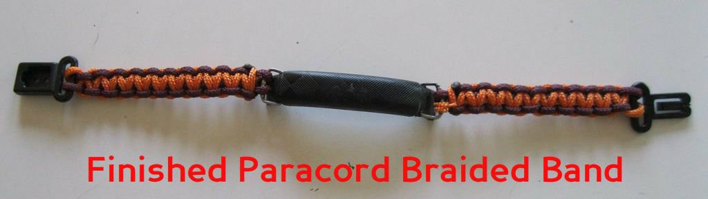

Fitness Trackers are a great motivational tool to get people moving more. The Jawbone UP2 is a good mid-priced model with a very nice app for tracking steps and sleep. The only major flaw is that the rubber wrist bands crack and break and there is no way to replace them. The first time it broke, we sent the whole unit back for replacement but, by the second time it broke, the warranty was up and that wasn't an option.
I searched the internet for articles on repairing/replacing the bands. Surprisingly, there was almost nothing out there so I decided to give it a try using paracord and some homemade loops. I was encouraged by the results of this first go at it. I think that with a little experimentation with paracord sizes and patterns and a little more care with the loops you could make some really impressive bands.

Step 3: Drill and Add Loops
  1. The tools section shows a hand drill but I ended up using a drill press so that I could clamp the device while drilling. The hole should be just slightly larger than the wire. I used a 1/16" drill for 3/32" wire.
  2. I used the stiffest small diameter wire that I had on hand. I pre-bent the wire to the shape and size that I wanted and then unbent part of it to slip it through the hold. I figured that, if I bent it after it was through the hole in the device, I would likely tear the plastic. I got the width right but I would make the depth less next time. I didn't have any experience with paracord braiding to know how deep it should be..
  3. After the wire is through the hole and re-bent, clip the wires to leave as small of a gap as possible without overlapping. This is important for the next step.
  4. Wrap the wire along clipped side of the wire. This provides a base to solder onto.
  5. Lay a coating of solder along the copper wrapped wire. Melt a bit of solder on the tip of a hot soldering iron for a good heat connection. Hold the iron against the bottom of the wire and the solder against the top of the wire. When it starts to melt you can move the iron and solder back and forth across the wire to make a smooth tinning job. Clip the excess copper wire ends as close as possible. Use a file to clean it up if necessary as any rough bits will snag the paracord and make it a pain to weave.

Now on to the final stage where you get creative and weave on you favorite paracord pattern. Piece of cake, right? Five-year olds are churning them out by the dozen, can't be that hard. If you are fifty-something and it is your first one, it can be a bit daunting to start. I did this project not just to salvage the Jawbone UP2 but also because I was looking for a reason to try paracord braiding. This isn't meant to be an Instructable on how to braid paracord, there are plenty of those but I will add a few of things that we figured out and a site with a good pattern for first-timers.
  1. I always thought that they used two separate pieces of paracord for multiple colors but often they actually fuse them together. There are lots of different methods to fuse the paracord and you can search them on the internet but, for this project, it is good enough to melt one piece with a candle and push it against the other to fuse it. Hold the pieces as close to the ends as possible so that you can push firmly without them wiggling too much. It may take a couple of tries to get it. If you can give it a firm tug and it holds, you've got it.
  2. The key to first time success, other than having a five year-old help you, is to use a simple two color pattern and have the pattern in front of you. The pattern that we used is here.
  3. To keep it nice and tight, you want do do as many loops as possible. That is usually one or two more that you think you can do. When you are finished, cut the cord, leaving about 1/4". Melt the cord using a lighter and shape it into a mushroom shape to lock the weave in place. Use a leather glove or a utensil to shape it so you don't burn yourself.
