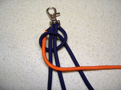

Take the center of the length of cord and bring it thru the attachment, I'm using a swivel clip. For this tutorial I'm measuring the wrist loop at about 10 inches from the attachment. The connection of the two colors will be just on the other side at this point.

The snake knot will be made 'around' the wrist loop section of paracord, the loop strands being the 'core' of the knot. I've added a series of photos showing the steps I use. By using two colors, you'll see that I flip the lanyard over after making each knot, so that I'm working with the cord on the right side of the lanyard. I bring it under all the other cords, working the hemostats under the previously tightened knot and pulling the cord back thru. Then tightening up the knot keeping the cord from twisting and working it up against the previous knot. Again flipping the work over, you'll see two parallel cords of the same color which will be split with the cord on the right going under, around, and pulled thru with the hemostats, then tightened up. Continue this procedure until you've done about 10 snake knots(you can count them down either side.

Thank you for this! For myself, the next time I try to make it: After you tie the very first knot with the orange cord, the rest is:
1. Flip the handle over
2. The stage left cord goes behind and around all the other cords
3. Insert tool from the bottom through the bottom-stage-left-most loop, pull cord through
4. Repeat

I must be dense... the photo's do not show the ENDS of your paracord...so to me it looks like you have FOUR pieces of cord to form the snake knot..... how you do that?
Reply 6 years ago
You're seeing the loop end and the two working ends that are tied around the loop end. ;)
