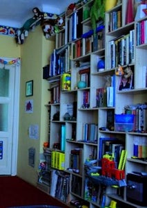

I made the first similar shelf twenty years ago. We moved into a new apartment and didn't have enough money left for furniture. I received a lot of 600x200 millimetres leftover particle boards from a carpenter friend, which cannot be used to make a traditional bookshelf, so I decided on a reciprocal frame. Everyone liked it, even though it was just a not-so-well-executed emergency solution. We recently moved again to another apartment, so I had the opportunity to rebuild more thoughtfully, keeping the following in mind:
- Sturdy: safety is number one!
- Durable: I wanted a piece of furniture that we could use for years.
- De-mountable: a big shelf like this needs to come apart or it will never leave the workshop!
- Practical: I can determine the size of the shelves, not the materials at my disposal.
- Cheap: the materials used were at my disposal. Therefore, I only had to spend my free time on it (186 hours).

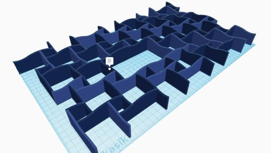

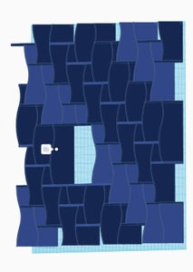

Step 1: Determination of Dimensions
We have a lot of books, most of them are paperback novels. Their average size is 200 millimetres. Therefore, the smaller shelf opening had to be made higher than this, so that the books could be easily moved. I sized the larger opening to double this so that the shelves are in line. To the resulting 660 millimetres I added twice the thickness of the shelf and got 700 millimetres. (This size is of course affected by the thickness of the material I used.) The shelves have two types of wave patterns, and on top of that I needed 1/3 and 2/3 length parts. To see through the chaos, I used Tinkercad. A real do-it-yourselfer uses linux. I don't like playing in a sandbox, Fusion 360 was not available to me this time :(.

Step 5: Pre- Assemble in the Shop
I made holes for the screws on the parts, 230 millimetres from the short edge. I started assembling the shelf system based on the Tinkerked drawings. I made a 220×220 and a 460×220 millimetres spacer from MDF. With the help of these, I drilled the parts together. The holes must be countersunk, because the head of the screw breaks the wood nastily. I placed the 1900 mm shelves last so that I wouldn't miss the location of the holes. I numbered the parts, on their rear edge, at the junctions. I have 118 nodes. I disassembled it and created the place for the nuts on the lower vertical parts, where I later put the adjustable legs. I also cut out the place for the parquet skirting board with a Japanese saw. I placed the hanging tabs on the upper vertical parts. and I created the cable hole on the long shelf.

Step 7: Home Installation
We live on the eighth floor of a flat, so I didn't need to test the load capacity of the walls. I simply measured where the concrete rebars and electric wires are located. I did the assembly by using the Tinkercad drawings, but even so, I missed the location of two parts, but I managed to correct it in time. I didn't hide the screws on purpose, most of them are covered by the books. After placing the books, I made smaller 460×120 millimetres shelves and 220×120 millimetres consoles to make better use of the space in the larger openings.
Step 8: Almost Finished
The bookshelf was assembled in one morning. In the afternoon, when my wife came home, she was very happy that her much-loved books could take their rightful place. While we were arranging it, it turned out that the long shelf was bending 7 millimeters under the heavy weight. That's why I supported it behind the television with two slats. Everything is perfect now.
