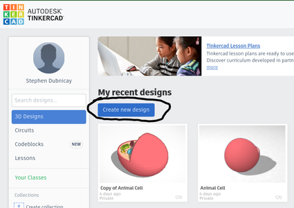

First, open your dashboard on Tinkercad, click on 3D Designs and create a new design.

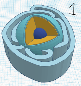

Once you have centered the smaller sphere inside of the larger sphere, drag and drop a box onto the grid, change the height to 4”, the width to 11” and the length to 6”. Then change the box to a “hole" box by selecting the hole button in the top right corner.

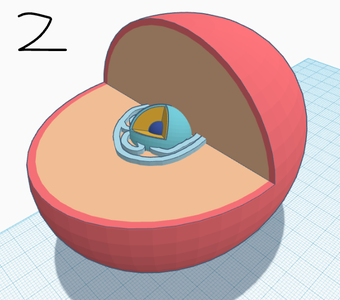

Next, align the box the same way as shown in photo 2.
Finally select the small sphere, large sphere, and the box, then group them. Once you group them you have to select the multicolor option in the color selector.
You should have something that looks like photo number 1.

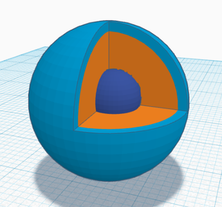

Step 3: The Nucleus
The Nucleus
First, drag and drop a sphere onto the build plate, change the height, width, and length to 2.25”.
 Then drag and drop another sphere onto the build plate and change the height, width, and length to 2”.
 Then try to center the smaller sphere inside of the larger sphere, once you have centered them, group the two together.
 Finally, drag and drop another sphere onto the build plate and change the height, width, and length to 0.75” and put it somewhere inside of the other two circles, then group them.

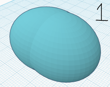

Step 6: Vacuole
First, drag and drop two spheres onto the build plate and change the width of both to 1” and the length to 1.2”.
Then shove the two together it doesn't really matter where, it should just generally look like a bent oval.
Finally, group the two spheres together and you should have something that looks like photo 1.

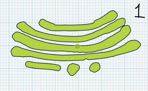

Step 7: Golgi Apparatus
First, drag and drop a scribble onto the build plate and try to draw something that resembles photo 1.
You may want to change the color, the color I recommend is b4d341.

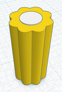

Step 8: Centrosome
First, drag and drop a cylinder onto the build plate and change the height to 1.02”, and the width and length to 0.250”. You may also want to change the color. The color I recommend is fafafa.
Then drag and drop a round roof onto the build plate and change the height to 1” and the width and length to 0.250”.
You may also want to change the color. The color I recommend is ffdd1a.
Then raise the round roof of the ground by dragging the black arrow above the shape and dragging it 0.01 above the build plate.
Then align the round roof inside of the cylinder as shown below:
Then copy the round roof, rotate it 90 degrees, and align it opposite from the other round roof.
Then select both round roofs, copy them and rotate 90 degrees.
Then select all four round roofs, copy them and rotate 45 degrees.
Finally, group all the round roofs and the cylinder together.

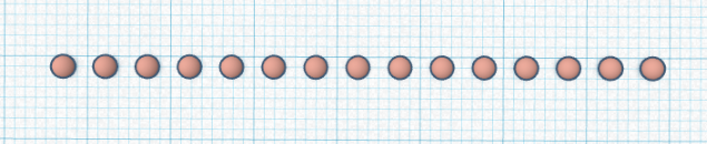

Step 9: Lysosome
First, drag a sphere onto the build plate and change the width, height, and length to 0.250”.
You may also want to change the color. The color I recommend is ecaa9b.
Finally copy the sphere about 15 times and leave them there for now.

First, drag the endoplasmic reticulum around the nucleus as shown in photo 1.
Next group the endoplasmic reticulum and the nucleus together and put the nucleus close to the center of the body of the cell as shown in photo 2.
Then group the body of the cell, the endoplasmic reticulum, and the nucleus together.
