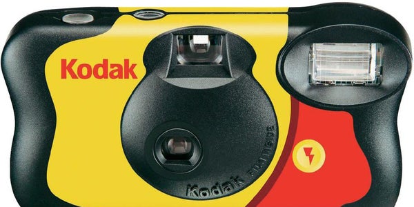

The main part of the stroboscope - the flash bulb was extracted from a disposable photo camera. The high voltage triggering transformer was taken also from there. On the same PCB can be found also some usable capacitors and transistors. The rectifier high voltage diodes were taken from the disassembled defected high efficiency lighting bulbs. The diac can be found also on this PCB.Additionally we need 10W 820 Ohm resistor, thyristor, some resistors and capacitors.

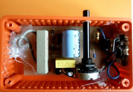

Step 4: The Assembled Device
All devices soldered on the PCB can be seen here. The flash bulb and the PCB are fixed by the use of hot glue.
On the second picture can be seen the whole assembled device.
This stroboscope was produced and tested in Europe, where the AC voltage is 220V. In USA it could work also, but may be some modification would be necessary - for example the voltage divider R3,R4 must be changed - R4 increased, R3 reduced. R4 could be even omitted.
In the device can be used other semiconductor parts - other available thyristor which can sustain 300V, other diac.
In some cases instead the diac a simple glow tube can be used.
Once again - the device must be placed in insulating plastic case!
Normally, if all used parts are functional, the device starts to work immediately after assembling. The frequency of the flashes can reach 10-20 per second. It is possible that after long use the flash bulb fails. I would recommend to use some connector for the bulb, which will allow fast replacement.
