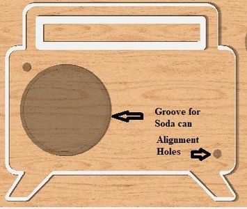

I have been looking at various Passive Amplifier Designs on line and trying to find one to make. Using my CNC software (Carbide Create), I designed the a Transistor Radio style Amp. I have uploaded a SVG file for those who wish to make one. Unfortunately I was unable to upload the Carbide create file as it is not supported by Instructables.

Step 1: Design
Start by designing the radio in Carbide Create. For those familiar with Carbide Create it was a fairly easy task as it was just a series of rectangles and circles. Then use the Fillet, Boolean and Linear Array tools while laying out and complete the design.
Step 2: Toolpaths
The toolpaths were created as follows
  • Pocket toolpath for the Speaker Holes, Knobs, Display background & Station Number.
  • Drill toolpath for the grill holes and guide holes.
  • Contour toolpath for the outlines.
When the design is completed simulate it in Carbide Create or your Cadd program to double check the design. Tweak the design until you are satisfied, then save the file.

Start by cutting the 1/4" dowel into two 1" pieces. Glue and insert the dowels into the holes in the back side. Cut the bottom off of the soda can leaving about 1/4" on the side. Insert the soda can bottom in the groove in the back side but do not glue it. Apply glue to the back side of the middle piece, align the dowels and assemble the two pieces. Use clamps to hold the two pieces tight till the glue dries. When the glue is dry remove the clamps. Apply more glue to the front side of the middle piece. Align the front piece with the middle and clamp tightly taking care to keep the sides aligned smoothly. If you desire to paint the knobs a different color do not glue them in place yet. Allow glue to dry.
