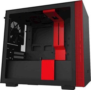

Case, Power Supply, CPU/Heatsink, (Thermal Paste) Motherboard, (Stand Offs, I/O Plate) ,RAM ,Graphics Card, (Power, SATA, USB, Fans, Front Panel) ,Hard Drive, Fans,

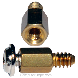

the sand off holes are the holes on the out side of the motherboard. this is where the screws go in to hold the motherboard in place in the pc. u have to insert the stand offs in to the case (pic 2 shows what a stand holes look) now u just need to find the corresponding holds under the motherboard to insert the stand off holes then you screw it in.

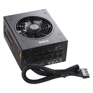

after u have you mother bored in you need to plug in you cords, that includes the power supple.
you will have to plug in the 20-24 pin,6-4 pin, then if u have a hard drive you will have to plug in the sata which comes out the power supple and then also the fans need to pugged in so the cpu has its own spot for the fan on top of the heat sink. and the case fans have there own spots on the motherboard (just pay attention to name of what the pins control. ) otherwise they won't work.
