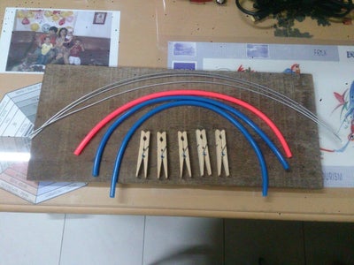

Step 1: Materials and Tools
Materials :
  • A piece of board with minimum 2 centimeters of thickness for better plug the hands.
  • Some fuel hoses.
  • Some 2 millimeters wire; measured a little longer then the fuel hose.
  • Some cloth-pegs.
Why "some"? Because you can make as many hands as you want. Here I make five.
Tools :
  • A pliers or two.
  • A wire cutter.
  • A drill along with an appropriate drill bit (equals or a little bit larger than the fuel hose).

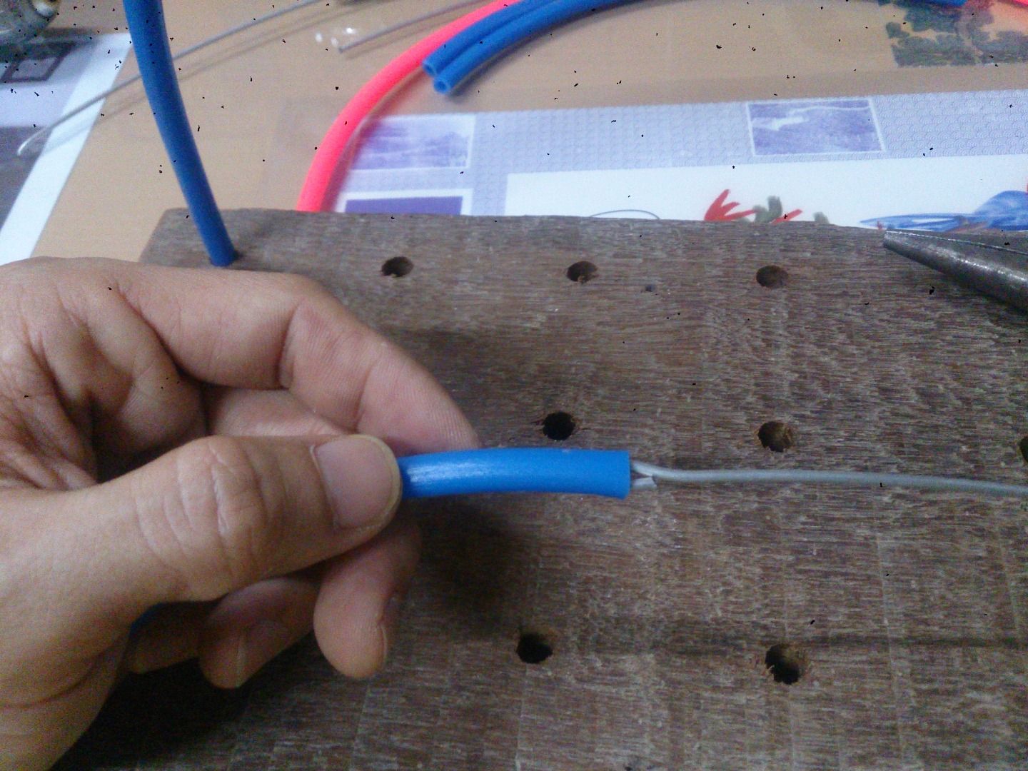

Make a node at one end of the wire. The board's hole is slightly larger than the hose. So we make a node to make it firmly fit in the hole. The hose itself is elastic, nothing to worry. You only need to get the node fit in the hole. I simply fold it back a little. All I can press with my pliers leaving an oval shape like the wire in the photo above. After covered with fuel hose, it makes a good grip in the board's hole.

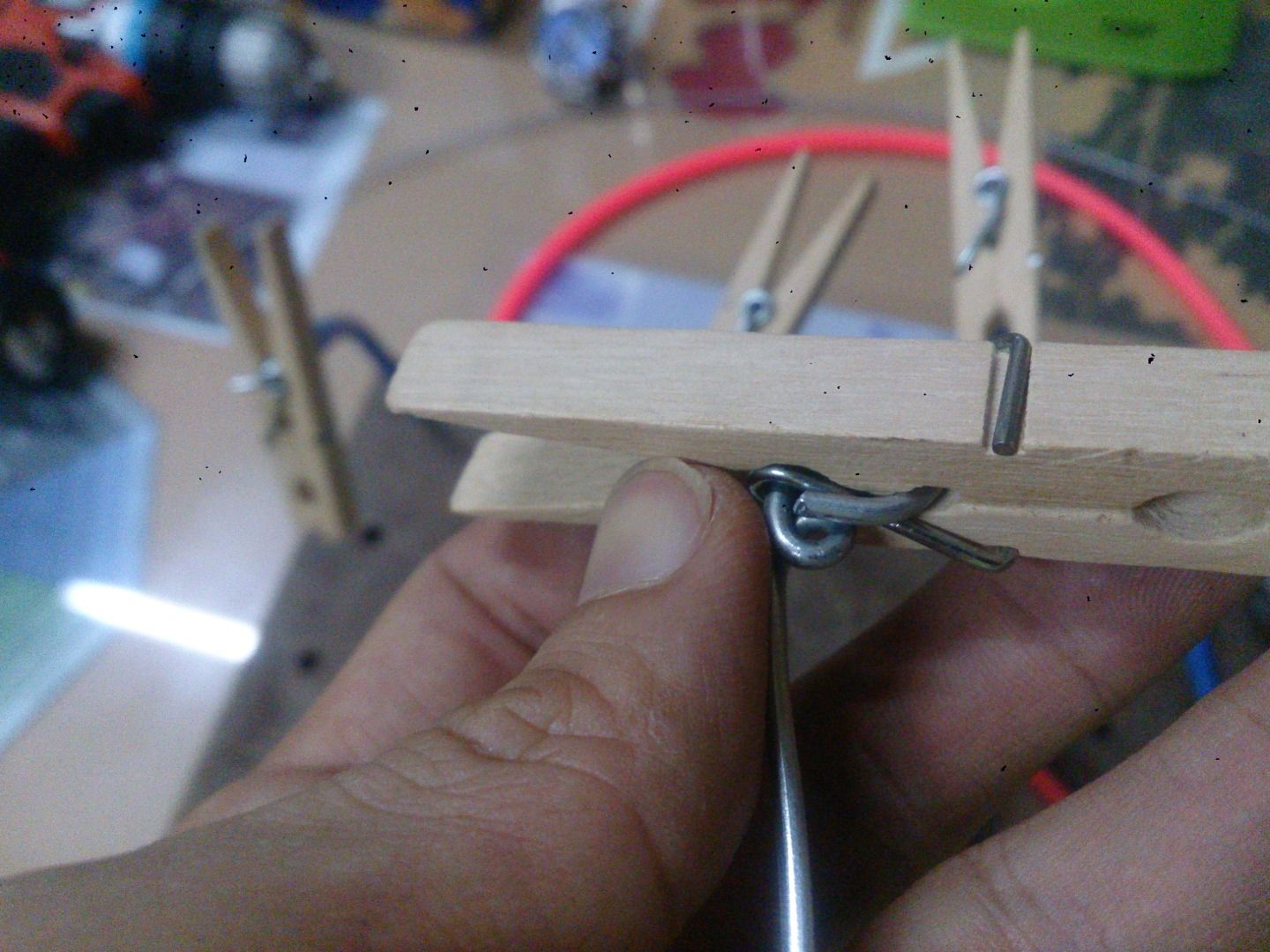

Make another node on the wire where the hose ended. Twist it like the picture below.
Put the remaining wire through the cloth-peg's spring hole.
Bend the wire down through the hole next to the peg's spring.
Then bend it toward the node on the spring's hole and cut the excessive wire off.
Sleeves the wire in the fuel hose and we are done. Now you can make as many as you want. It's okay if you make an ugly nodes for the first one. You will make a better one on the second, third, and so on... trust me ^_^

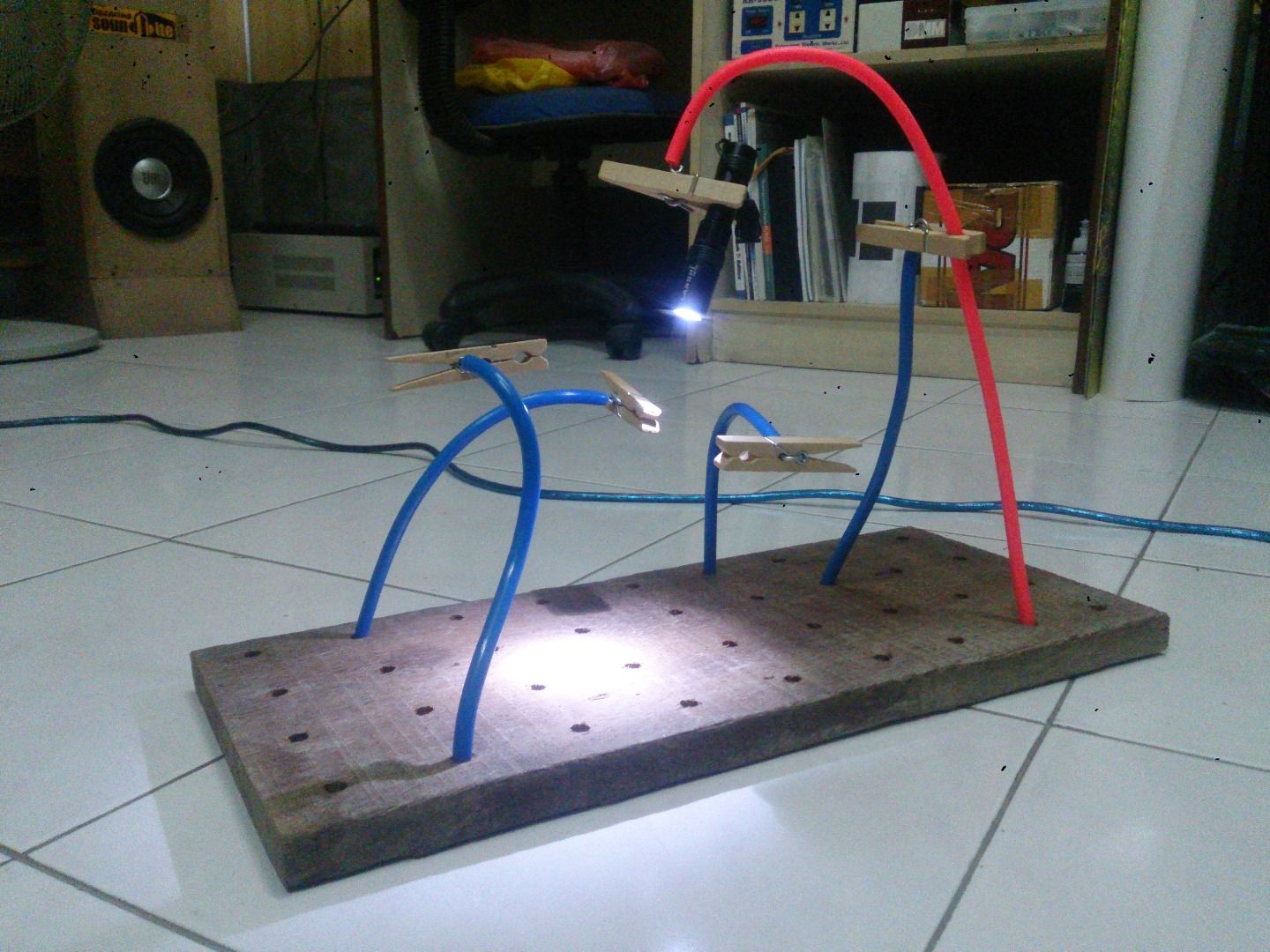

Step 5: How Much Weight Can They Hold?
They can hold a bare harddisk drive. One hand can hold my pliers. I also use them for smartphone photography, taking pictures for iBles projects. Of course the main purpose is holding electronic boards for service and soldering and this one can hold a computer motherboard for sure ;-) although I never repair a motherboard ha..ha..ha..
It can hold a mini flashlight while working. And we can also use 'Hand in Hand', another hands can help holding one hand steady. So Flex and useful to me.
