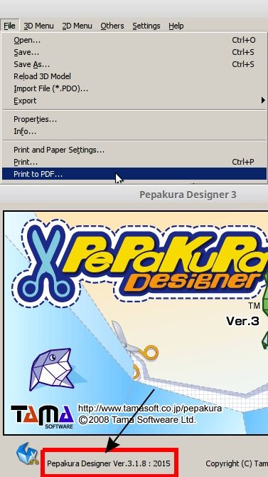

    The latest version of Pepakura Designer has a "Print to PDF" option.
    0
    krsiak
    krsiak
    Reply 6 years ago
    Hi, thanks.
    I will update the tutorial and still this may stay valid for those using older version.

    I got really angry. Sorry. Why we dowload Cutepdf?? I wasted my time. Just download Pepakura Designer, open pdo file and 'print to pdf', it is ready. Thanks
