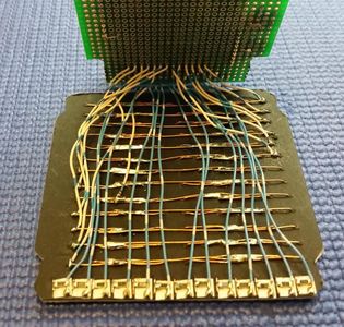

In the example I used high intensity white surface mounted LEDs that I cut from a 3v LED strip. Join the Anode (+ve) side of each LED in each vertical column together on one side of the cardboard. Then pass the Cathode (-ve) through to the other side of the cardboard through a hole and join each row together on that side. What you end up with is 13 Anode strips on the LED side vertically and 13 Cathode strips on the other side horizontally. These are then connected to the Arduino Shield from the previous step as per the circuit diagram.

In order to avoid the complexity and time required to have to put LED drivers in the circuit I have used an Arduino Mega to drive a 13x13 array of LEDs. The Arduino reads the RTC time and then draws the display by turning on one LED at a time. It does this by addressing each LED systematically using X,Y coordinates. The LEDs are protected by 150 Ohm resistors and being that they are only activated individually means the current is limited.

Use hookup wire to connect the Arduino PCB, Buttons and RTC on the Shield as per the diagram. Play particular attention to the wires and position of the components to ensure they are fit snuggly and securely in the case.

Hey what did you use to connect the LEDs at the back and what type of wire did you use?
0
TechKiwiGadgets
TechKiwiGadgets
Reply 5 years ago
I used single core hookup wire with the insulation stripped off. You can see in the photos the blue and white hookup wire between the LED board and the Arduino sheild. Its less than 1mm diameter.
