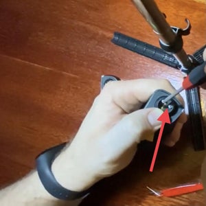

Let us start the disassembly by popping off the shaver head and looking if this exposes any screws underneath.
Seeing the two Philips head screws on top, we can proceede and remove them.
As this didn't do much, we need to establish what next should we try removing, and this is a bit of trial and error, as pulling too hard on some of the elements and we will break them.
It is therefore important to first try to slide the plastic elements (in case they have L-shapped hooks) before trying to pry (also gently) them up.
