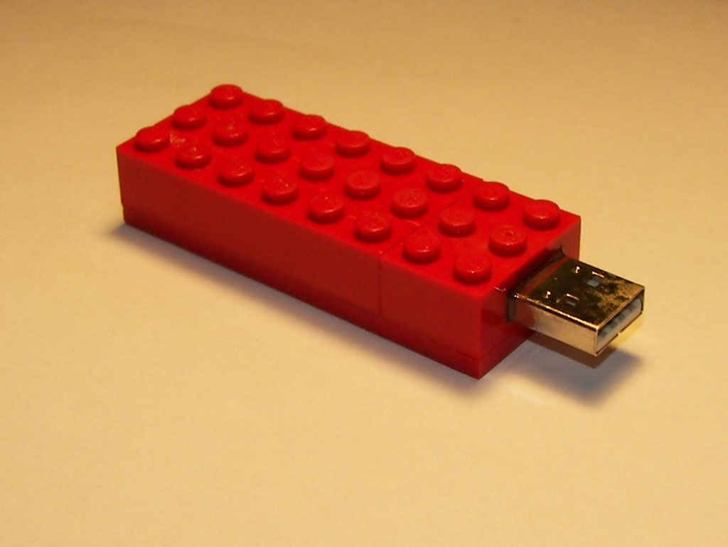

Step 6: Light Box in Use
:: UPDATE ::
The 4 images below are of it in use. From here I would clean up the images and remove all the lines, but that is the easy part.
