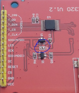

While ILI9341 SPI displays are supported, the higher resolution of the ST7796 (480x320) makes it more suitable here. The display requires a 300 KB frame buffer, which exceeds the 264 KB RAM of the original Pico but fits within the 520 KB of the Pico 2 and Pico 2W.
The ST7796 display I used has an SPI interface, and is inexpensive and widely available. I chose a 4.0-inch version. Ensure the display you choose supports SPI and is supplied with the correct voltage. Some displays allow selection between 5v and 3.3v using a jumper.

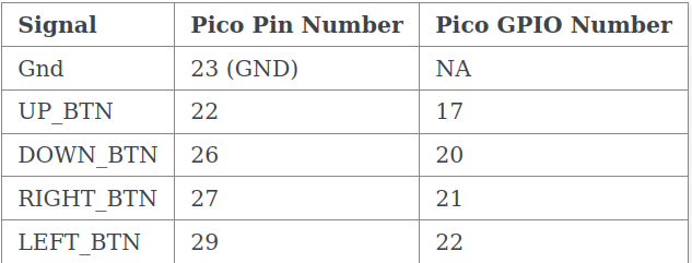

Displays with 3.3v I/O are directly compatible with the Pico. The “4-wire” SPI interface requires only MOSI and SCK, along with chip select (CS) and data/command (DC) lines. While the display includes a hardware reset pin, it can be safely tied to 3.3v, and I have found software reset to be reliable.
See the attached images for the wiring of the display and the buttons.

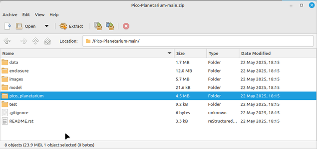

Step 3: Get the Code
The code is available on github.The Planetarium code is written in pure C++, but a demo application is provided as an Arduino sketch in the "pico_planetarium" folder.

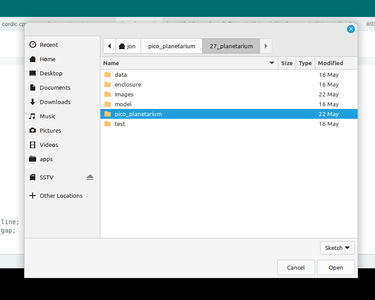

Step 6: Upload Sketch to Pico
- From Arduino IDE, open the pico_planetarium sketch.
- There are some settings in the sketch that can be edited (comment/uncomment as required) this allows the screen rotation to be changed, or to enable/disable WIFI features.
- Select "Raspberry Pi Pico 2W" as the board type.
- Connect Raspberry Pi Pico 2W using a USB cable. (If your Raspberry Pi Pico is new, hold the bootsel button while plugging it in, it should appear as a USB drive).
- Select "sketch" and "upload sketch".
