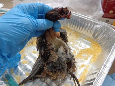

Step 5: Cover Skin in Borax/salt
Once you have taken out all of the flesh and organic bits, you basically dry the rest out by filling the skin with borax and/or salt, and letting it sit and dry out.
This will also kill any germs still living on the skin (although that said, I would suggest not using the skin of your animal as food decoration or children's playthings. Hygiene, people. We live and die by it.)
At this juncture I am also including photos of my quail skin freshly emptied. He is a little, um, scary looking. Luckily I had a pro at my side to constantly remind me that my first adventure in skinning was not going to yield a masterpiece, so I am passing on evidence of that to you, dear instructablees. Be careful with your skin, but don't be precious, or you will be scared away from the task at hand (and very possibly from your accomplishment at the end as well.)
