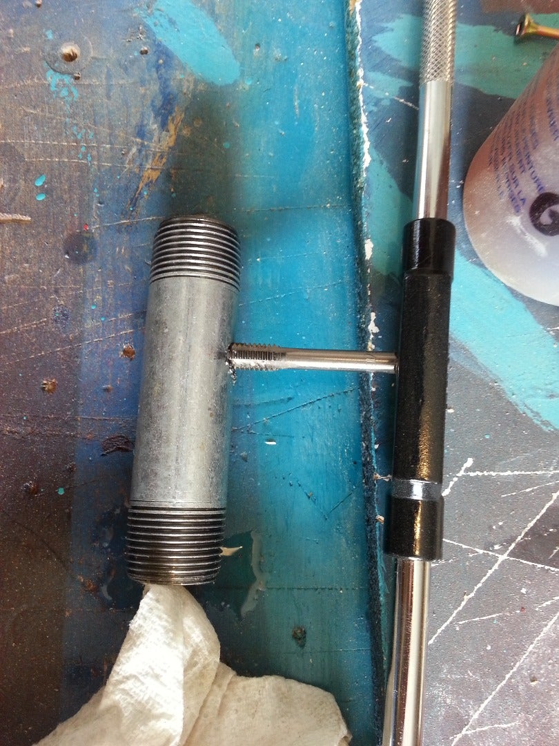

Step 2: The Pivots
Two each:
  • 1/2 inch floor flange
  • 1/2 nipple
  • 3/4 to 1/2 inch reducer
  • 3/4 threaded pipe
  • 3/8 pipe
  • 18-25 inches of galvanized slotted steel angle
Each side of the rotisserie needs a pivot. Drill and tap a hole in the 3/4 inch pipe for a 5/16 bolt, which will lock the rotisserie in place. Screw the flange onto each end of the frame. Add the nipple, reducer and 3/4 inch galvanized steel pipe. I ended up cutting my 3/4 and 3/8 inch pipe shorter with an angle grinder and filing the cut ends to remove burrs. You only need enough room to insert a bolt with a knob and be able to turn it. Attach the 3/8 inch pipe to the steel angle. I welded mine (exceptionally poorly!), but you could maybe use JB Weld if you don't have a welder. If you do decide to weld, note that galvanized steel produces some very nasty fumes when heated. I did only these two small welds in a well-ventilated garage. The angle/pipe combo will just sit in the 3/4 pipe.
