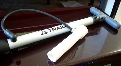

I wasn't sure how much pipe I would need, so I cut about 10" to prototype with. That ended up working just fine in the end.
In a well-ventilated (preferably outdoors) area, use the PVC cement to glue the end cap onto one end of the pipe section. The lids are on real tight, I had to use the channel-lock to open it up.
Next use your power drill to make a hole that is slightly smaller than the threaded portion of the Hose Barb, that's important so you don't need glue or pipe thread tape or o-rings or anything else to make an air-tight fit for the hose barb.
I had to use the channel-lock to screw the threaded end of the hose barb into the PVC Pipe. That should be the most challenging part of this instructable.
In the pictures I have inserted the hose barb into the pipe's side. You may want to consider positioning it in the center of the end cap when you see how it will have to be positioned inside of the cannon in part 2 of this instructable

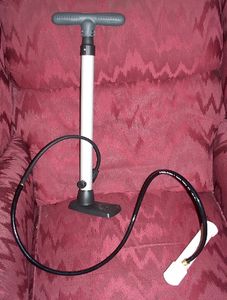

My first draft was working so well I decided it could serve as the final production model.
But based on the Styrofoam cannon I made last year, this hose is way to short to position the operator behind the cannon (as opposed to beside the cannon).
Another trip to the store fetched me 3 more feet of hose similar enough to the bike pump's hose & a Barb Splicer. You can tell the difference in hose length in this photo.
