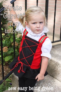

Hey there, Landlubbers!  Or, uh, ahoy!  Yep.  That's it... Ahoy!
Here's the first step to making a stellar pirate costume for the little lady in your life-- the pirate corset top!

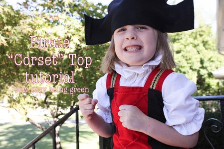

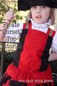

I did the tutorial on the top that has the RED in the front and BLACK on the sides-- just so you don't get confused! :)

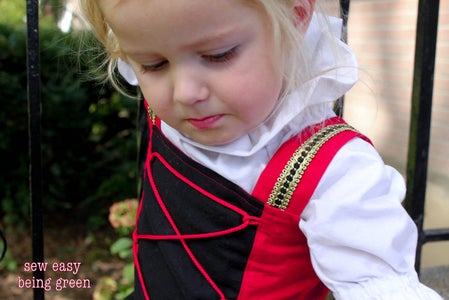

Grab your rick rack or other trim and weave it through the loops you made in the front.
